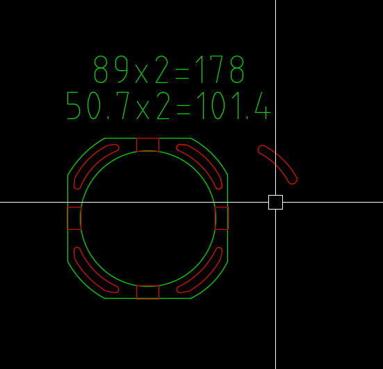

Some drawing for clear view:

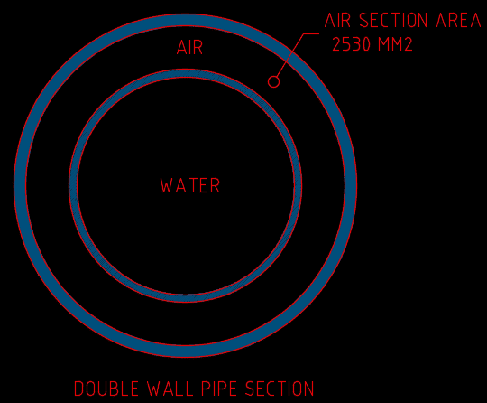

1. Double wall pipe section
Cross-section of a double wall pipe: a thick outer ring labelled AIR, an inner ring with WATER inside, and a callout reading AIR SECTION AREA 2530 MM2.

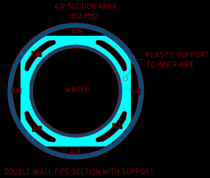

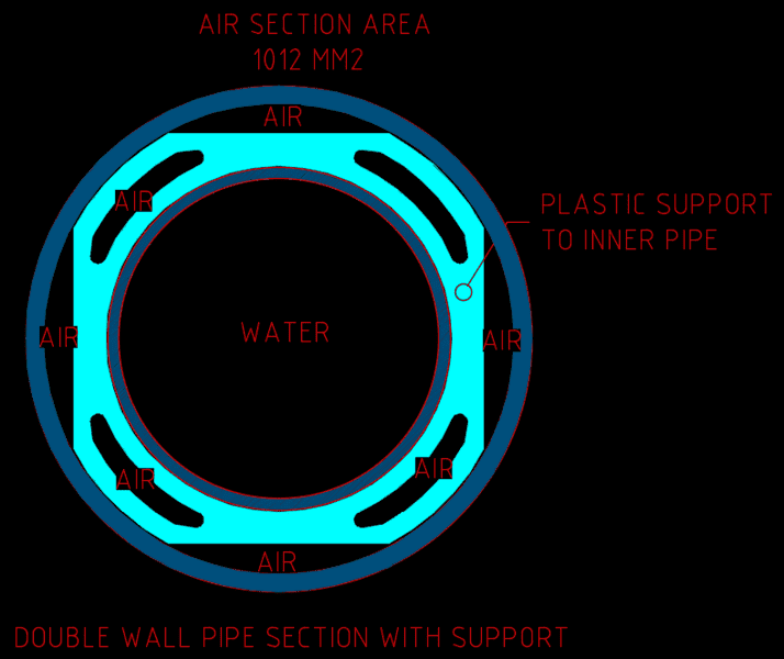

2. Double wall pipe section with support, the support is obstruction to the air flow similar to orifice.
Cross-section of a double wall pipe: an outer ring labelled AIR SECTION AREA 1012 MM2 surrounds an inner circle labelled WATER, with four plastic supports to the inner pipe and air regions marked around it.

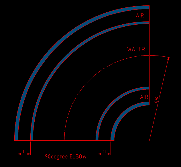

3. Elbow
Cross-section drawing of a 90 degree elbow showing concentric annular passages: labels AIR, WATER and AIR, with dimension 11 and radius R76 marked.

  • CAD section of a double wall pipe: outer octagonal-style outline with inner circle, four red arc-shaped supports and red tabs, with annotations 89 x 2 = 178 and 50.7 x 2 = 101.4.

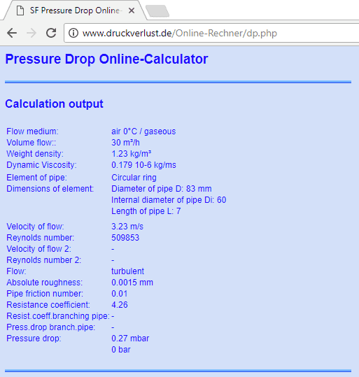

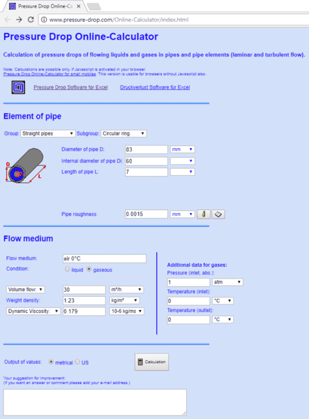

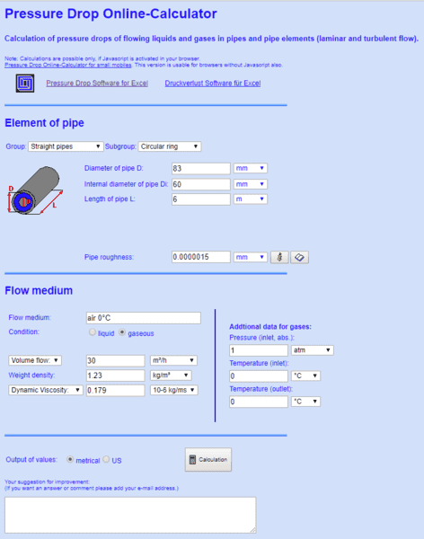

I found a online calculator exactly same to this matter but the result is quite different in Reynold number (509853 versus with 4988 as mine calc.) caused me confusing, can you please have a look and advise the reason? below is the link of software and information input/output.
http://www.pressure-drop.com/Online-Calculator/index.html
Input calculation
Screenshot of the Pressure Drop Online-Calculator web page showing inputs for a straight circular ring pipe: diameter 83 mm, internal diameter 60 mm, length 7 m, roughness 0.0015 mm, air at 0°C, flow 30 m³/h, density 1.23 kg/m³, dynamic viscosity 0.179 10-6 kg/ms.
Output calculation
Screenshot of the Pressure Drop Online-Calculator at druckverlust.de showing calculation output for air at 0°C: volume flow 30 m³/h, velocity 3.23 m/s, Reynolds number 509853, turbulent flow, pressure drop 0.27 mbar.
  • Screenshot of the Pressure Drop Online-Calculator web form set to a circular-ring straight pipe, with diameter 83 mm, internal diameter 60 mm, length 6 m, roughness 0.0000015 mm, and air at 0°C with volume flow 30 m³/h.
  • Screenshot of the Pressure Drop Online-Calculator web page showing inputs for a straight circular ring pipe: diameter 83 mm, internal diameter 60 mm, length 7 m, roughness 0.0015 mm, air at 0°C, flow 30 m³/h, density 1.23 kg/m³, dynamic viscosity 0.179 10-6 kg/ms.

longz said:
Hi Chestermiller,
Input calculation
Output calculation
In their calculation output, the viscosity used looks too low by a factor of 100.
Hi Chestermiller,
Thank for advices, you are correct. I changed the value of the viscosity and the software output similar to mine calc.
To pressure drop of inner pipe support ring, could you please advise some instructions ? I considering this is multi-hole orifices plate but the point is the holes is not same and have multi plates on the pipe route. I don't know how to start the calculation.
longz said:
Hi Chestermiller,

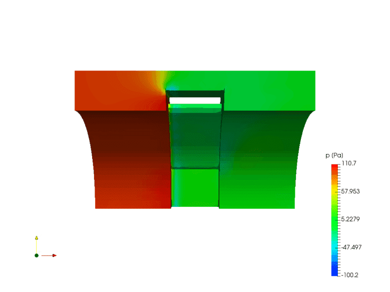

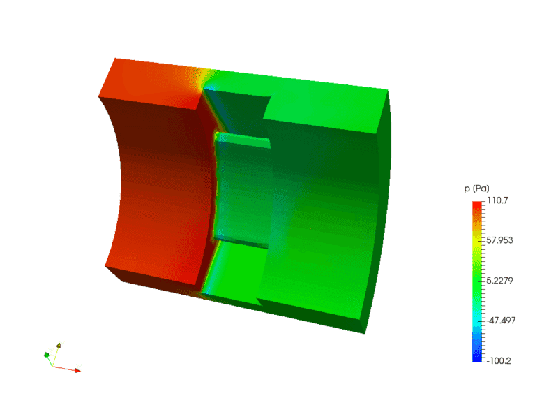

In a case like this, you have to use your best judgment as to whether the multi-hole is adequate. Compared to the total pressure drop, how much does the pressure drop across the plate matter?
CFD pressure contour plot on a 3D duct section with a support plate, colored from red (high) to blue (low) with a colorbar labelled p (Pa) from -100.2 to 110.7; flow is left to right.
Simple CFD analysis using the default laminar flow model in OpenFoam .
5 m/sec uniform air velocity at inlet . Zero pressure (gauge) at outlet . Air flows from left to right .
So roughly 110 Pa pressure drop per support plate . Almost nothing really and certainly negligible .
CFD contour plot of gauge pressure p (Pa) over a cross-section of a double-wall duct with a support plate, colour scale from -100.2 to 110.7 Pa, red high on the left and green low on the right.

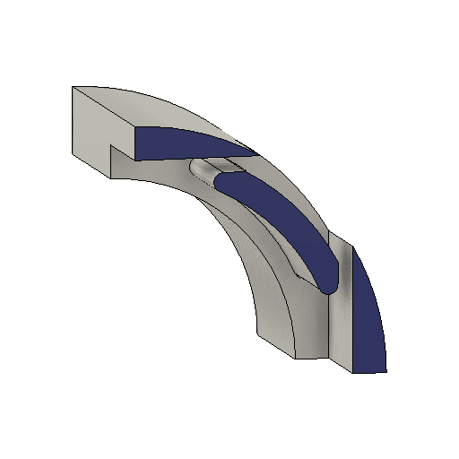

Cutaway 3D CAD view of a curved duct section with a double wall, showing a grey outer shell and a dark blue cross-section highlighting the inner wall and a support plate.
