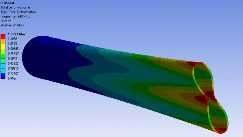

There was someone that posted a question about tube resonances and why the thick walled tube had a higher frequency. But it is gone?!? Anyway, I'm stubborn (and actually put some effort in the answer), so here is my answer anyway:
Question:
A tube with outer diameter of 76mm and length of 1m is hit, why does the tube with wall 2mm have a higher frequency than the one with 1.5mm diameter. How does this relate to a pipe organ.I've done a very quick FEM modal analysis. I think the deformation mode for sound is not a bending motion but rather something like below, where the wall of the pipe is deformed. In the solution below the 2mm wall has a significantly higher eigenfrequency than the 1.5mm thick wall. So stiffness wins from mass in this case.
Also, a pipe in a pipe organ is a helmholtz resonator. This is all air that is moving, not the pipes themselves. This means that thickness should not have an influence there.
1.5mm thick:
2mm thick:
