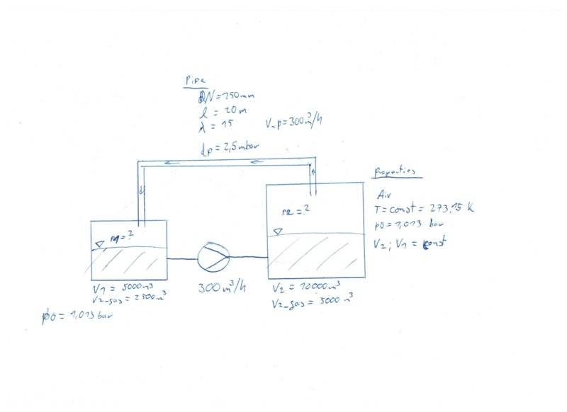

Two half with a fluid filled vessels are connected through two pipes in a closed system. The bottom pipe pumps the fluid from vessel 1 to vessel 2 at a rate of 300m³/h. The fluid pushes the air of vessel 2 through the top pipe into vessel 1. What is the pressure within the vessels? Drawing attached.
Data
Pipe:
DN = 150 mm
l = 20 m
Zeta = 15
Vessel 1:
V1 = 5.000 m³
V2_Gas = 2.500 m³
Vessel 2:
V2 = 10.000 m³
V2_Gas = 5.000m³
Overall:
p0 = pressure before the pump starts = athmospheric = 1,013 bar
T = const = 273,15 K
V1 = const
V2 = const
EDIT: In the drawing lambda should be zeta
p*V=n*R*T ?
I calculated the pressure drop within the pipe to be dp = 2,5 mbar.
Now I assume that when the pump starts the pressure p2 in vessel 2 will equal the pressure loss within the pipe plus p0. I use the ideal gas law to calculate the mass of the air within vessel 2 at the pressure p0 and p0+dp. I calculate the difference between the mass at p0 and p0+dp and substract it from the mass in vessel 1. Now I calculate the pressure in vessel 1 with the calculated mass.
I guess it's not right. I have spent a long time in the library to find a similar problem but couldn't find anything. I would really appreciate your help. Thank you all in advance. PS: Please excuse my english.

Apparently you need ##\Delta p = ## 2.5 mBar to sustain the 300 m3/h volume flow of the gas. In V1 the gas volume increases, so the pressure wants to drop; in V2 the gas volume decreases, so the pressure wants to rise. As a good democrat, I would split the ##\Delta p## over the two vessels. You'll need a very good pressure meter to notice such a small deviation :wink:
Hey BvU I guess that would be correct if both vessels had the same volume.
If I use my suggested method I get your proposed result.
Thank you for welcoming me!
I see what you mean. I estimated an equal split based on the flow, but you are probably right and come to a 2:1 ratio based on the relative change in Vgas

Here's my take on this:
$$n_1=\frac{p_1(V_{10}+\alpha t)}{RT}\tag{1}$$
$$n_2=\frac{p_2(V_{20}-\alpha t)}{RT}\tag{2}$$
where ##\alpha=300\ m^3/h##, ##V_{10}## = gas volume in tank 1 at time zero and ##V_{20}## = gas volume in tank 2 at time zero. Since the total number of moles of gas is constant, $$p_1(V_{10}+\alpha t)+p_2(V_{20}-\alpha t)=p_0(V_{10}+V_{20})$$At short times (like you have been analyzing so far),
$$p_1V_{10}+p_2V_{20}=p_0(V_{10}+V_{20})\tag{t ---> 0}$$This is what you would use in conjunction with the pressure difference to get p1 and p2 individually.
If we take the time derivatives of Eqns 1 and 2, we obtain:$$\frac{dn_1}{dt}=\frac{(V_{10}+\alpha t)\frac{dp_1}{dt}+\alpha p_1}{RT}\tag{3}$$
$$\frac{dn_2}{dt}=\frac{(V_{20}-\alpha t)\frac{dp_2}{dt}-\alpha p_2}{RT}\tag{4}$$
Eqn. 3 gives the rate of change of the number of moles in tank 1, and this is also equal to the molar flow rate from tank 2 to tank 1. The mass flow rate from tank 2 to tank 1 is obtained by multiplying by the molecular weight M: $$\dot{m}=M\frac{(V_{10}+\alpha t)\frac{dp_1}{dt}+\alpha p_1}{RT}\tag{5}$$
The Reynolds number is given by: $$Re=\frac{4\dot{m}}{\pi D \mu}\tag{6}$$
I think I'll stop here for now and give you a chance to digest this.

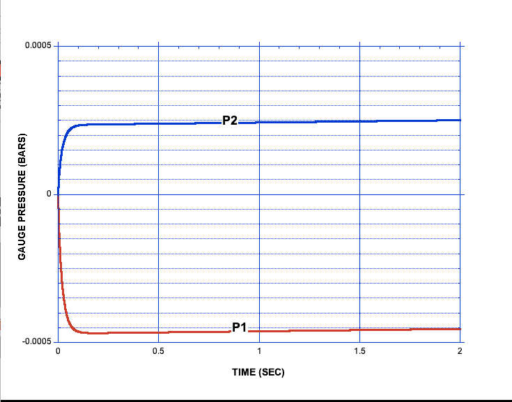

I analyzed the case where zeta is neglected and, for the parameters in this problem, came up with the following ordinary differential equation:
$$\frac{d[P_1(V_{10}+\alpha t)]}{dt}=-\alpha+5.27(P_2-P_1)^{4/7}$$where ##P_1=\frac{p_1}{p_o}-1##, ##P_2=\frac{p_2}{p_o}-1##, ##V_{10}## is in m^3, t is in seconds, and ##\alpha =\frac{1}{12}\ \frac{m^3}{sec}##.
The numerical solution to this equation, shown in the figure below, indicates that that the system approaches quasi steady state very rapidly (within two seconds). In the case of this figure, since we assumed zeta is negligible, the final quasi static pressure difference between the two chambers is predicted to be only 0.7 mBar, compared to 2.54 mBar when zeta is not neglected.
Physically, the term quasi static means that the flow resistance of the pipe is very low, and that the pressures in the two chambers will be nearly equal at all times. So the present analysis provides mathematical justification for the approximation that you made in your original post that (a) the volumetric flow rate in the pipe is essentially 300 m^3/hr and (b) the density of the air does not vary significantly from 1.29 kg/m^3. This led to the result that $$p_2-p_1=0.00254\ bars\tag{1}$$
Even though the pressure difference between the two chambers rapidly reaches a constant value, the individual pressures in the two chambers will vary with time t. These individual pressures at any time t can be determined by solving Eqn. 1 simultaneously with the equation:
$$p_1(V_{10}+\alpha t)+p_2(V_{20}-\alpha t)=p_0(V_{10}+V_{20})\tag{2}$$where po is 1.013 bars.
What do you get when you solve this at t = 0? What do you get when you solve this at t = 30 sec (the time when tank 1 becomes empty)?
I guess that it is best to report the pressures in the tanks as gauge pressures (to avoid roundoff in the answers).
