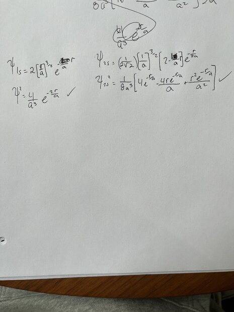

So I used the radial wave functions from this website, http://plato.mercyhurst.edu/chemistry/kjircitano/InorgStudysheets/InorgWaveFunction.pdf
and basically squared each wave function. I am given the radius of a nucelus which is r=1x10-15.
So I plug that in for r in the function and also need to plug in for a.
Does that seem correct?
It is correct as far as squaring the wavefunctions is concerned. That's step 1. What comes next?
It should just be plugging in. Do you know where I can find the value of a? I wasnt given that information
Just leave it as a. Maybe it will cancel out. If by "plugging in" you mean replacing ##r## with ##R##, that is incorrect. You need to do an integral.

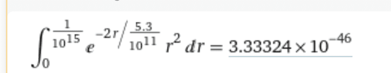

I used wolframalpha and got this
Which I guess makes sense. The probability of this happening is very unlikely, but not zero.

I used wolframalpha and got this View attachment 299621
It would be better to do the integration symbolically first then plug in numbers. Also so we can see if it is correct.
That's not what I got.
I used a different program and I got 1x10-11, but that was with using the value 5.3*10-11 for a0 that i found on google.
