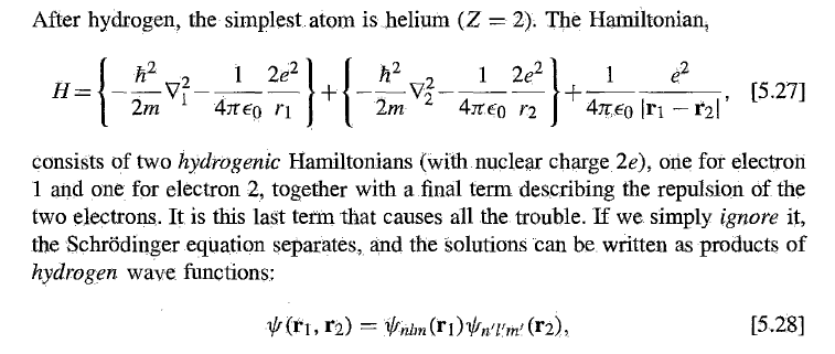

I am having a trouble to understand why the helium's wave function (in which we are ignoring the electric interaction between the electrons, as well the motion and problems that arise in considering the nucleus in the wave function) can be written as the product of the wave function of both electron.
I mean, being the electron fermion particles, shouldn't it be written as:
$$\psi = (\psi_{(nlm)'}(r1)\psi_{nlm}(r2) - \psi_{(nlm)'}(r2)\psi_{nlm}(r1))/{\sqrt(2)}$$

Instead the equation i gave, the book claims that the wave function is:
$$\psi = \psi_{nlm} \psi_{(nlm)'}$$
Textbook page showing the helium Hamiltonian H as a sum of two hydrogenic terms, each with kinetic and nuclear attraction parts using 2e, plus an electron repulsion term e^2/(4 pi eps0 |r1 - r2|), labelled [5.27]; followed by the separated product wave function psi(r1, r2) = psi_nlm(r1) psi_n'l'm'(r2), labelled [5.28].
ψ=ψnlmψ(nlm)′
He says explicity that is a solution of the SDE. He hasn't yet considered the anti-symmetrization requirement - which, in any case, requires consideration of the spin state.
Good point. That's it
