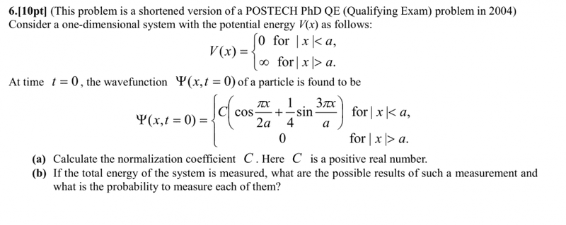

Problem statement: piecewise potential V(x) = 0 for |x| < a and infinity for |x| > a; initial wavefunction Psi(x,0) = C(cos(pi x/2a) + (1/4)sin(3 pi x/a)) for |x| < a, zero otherwise; parts (a) and (b).
I solve the (a) , using even,odd function. So, C=1/a
I don't know how to approach (b).
I think that 'total energy of the system' doesn't mean expectation value, how can i get
total energy and probability of them?
If you measure the energy, the system can only be found in one of the eigenstates of the Hamiltonian.
