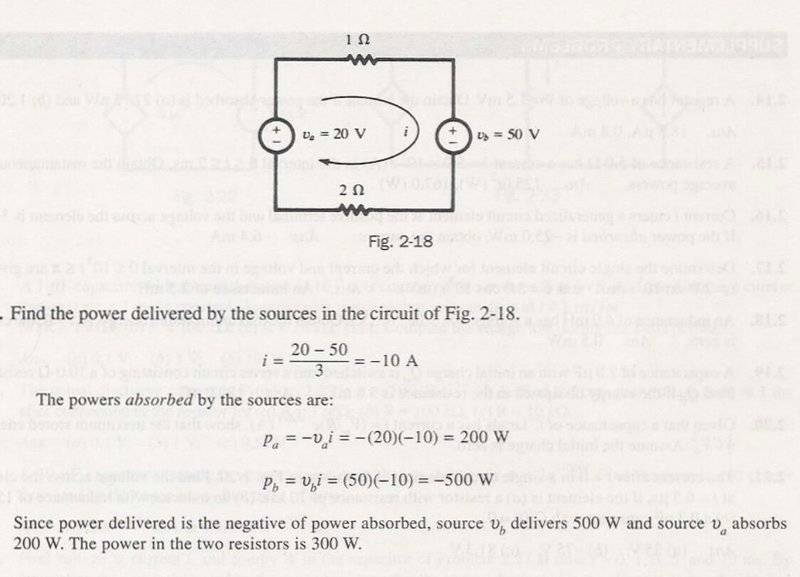

Problem in Fig 2-18 and its solution:
Passive Sign Convention, I think.
Let's say i is counter-clockwise. Then, it's going from - to + of v_b. Why is there not an additional negative sign in computing p_b, and why is there one in computing p_a (where i being counter-clockwise means the current is negative, despite the image having the current be clockwise)? (I'm trying to follow the work as done in the pdf I linked to.)
Any input would be GREATLY appreciated!

The way I remember learning it: if current is coming out of the positive terminal of a voltage source, then the voltage source is delivering V*I. But in this case I is negative, so it is actually absorbing power.
The symbol i is already in use on the diagram, so you can't decide to use it for something else, and on the diagram you can see that i is their clockwise current.
As scottdave reminds us, power delivered by a source = terminal voltage x current output
where current output is that emerging from the source's output terminal, the one here marked + .
Sticking with the nomenclature of the diagram, for source B: Pout = vb x (–i)
because that source's output current is opposite in direction to what is already denoted as i.
Sorry about that, and thanks for the help! I get it now!
