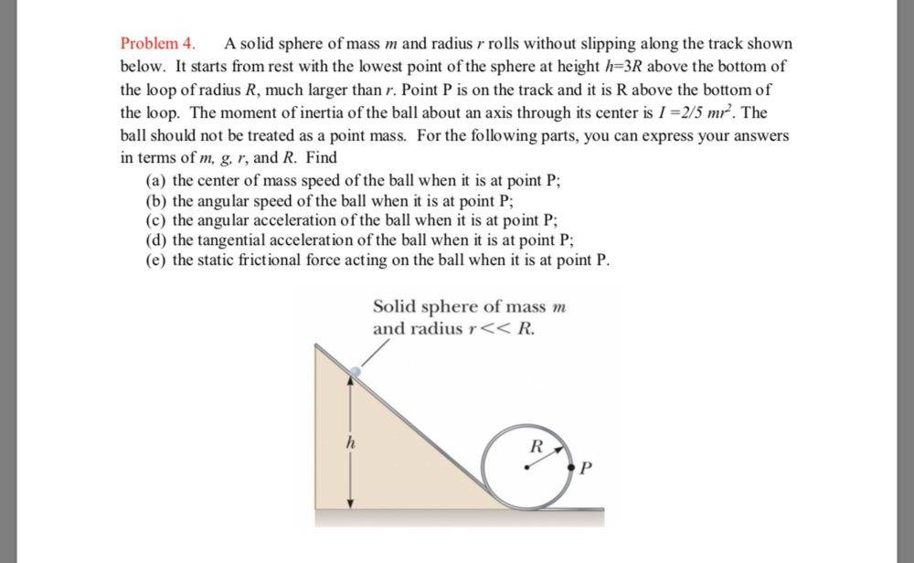

A solid sphere of mass m and radius r rolls without slipping along the track shown below. It starts from rest with the lowest point of the sphere at height h=3R above the bottom of the loop of radius R, much larger than r. Point P is on the track and it is R above the bottom of the loop. The moment of inertia of the ball about an axis through its center is I =2/5 mr2. The ball should not be treated as a point mass. For the following parts, you can express your answers intermsofm,g,r,andR. Find
(a) the center of mass speed of the ball when it is at point P;
(b) the angular speed of the ball when it is at point P;
(c) the angular acceleration of the ball when it is at point P;
(d) the tangential acceleration of the ball when it is at point P;
(e) the static frictional force acting on the ball when it is at point P.

For parts A and B I used energy to find the vcom and omega, but that won’t work for C. I have an answer by combining the three formulas that use acceleration above. My answer for alpha=-5g/3r. The next two are easily solvable if you find C, but I still feel like I’m missing something. Any help would be appreciated, but don’t give me the answer. Let me try and work through it with whatever tips and pointers I can get. There is a picture attached of the problem
  • Physics diagram of a solid sphere of radius r rolling down a slope of height h onto a circular loop of radius R, with point P marked on the track at the loop's upper right side.
