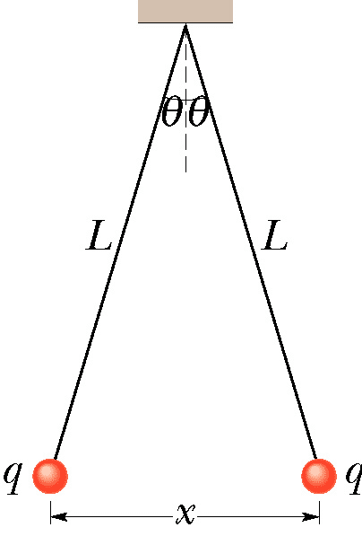

One more query.Two identical small bodies each of mass m and charge q are suspended from two strings each of length l from a fixed point.This whole system is taken into an orbiting artificial satellite, then find the tension in the two strings?
I know in satellite g=0. Therefore there won't be any weight acting downwards
only forces which exists between the balls will be
Coulombs force of repulsion + mutual gravitational force attraction between bodies + gravitational force of attraction of the satellite on the bodies
However, magnitude of above said gravitational forces will be negligible as compared to coulombs force. Hence this coulombs force of repulsion can be considered the only force between the balls which will repel them .But the answer given is T= (1/4πε0)*q^2/4l^2
This suggests r=2l
I want to know how to find "r"how r came out to be 2l?
probably the following image will suit the situation in the question.
In your image, what will the angle ##\theta## be in the absence of an external gravitational field?

What forces are acting on the masses? What will be the requirement for the masses being in equilibrium?

Lets do a thought experiment. Imagine that the two charges are held exactly where they are in the picture in the OP. You then let go of the charges. What happens?

Do this: Name the forces that act on each mass. Hint: Only two (significant) forces act.
Draw (or describe) the configuration of the masses. What angle will the strings make?

Try to describe it, what is the angle theta in your figure going to be?
One thing i would like to clarify is the above picture was not a part of the question in op.I copied it from google images.So as we can see nothing bout theta is mentioned in the question.

I know that, but I am asking you what it will be anyway. It is fundamental for the understanding of the problem.
It doesn't matter, that picture is very useful in anyway.
What I'm trying to do (and, I believe, so is Orodruin) is to get you to visualize what is happening. Once you have a good mental picture, the rest will be simple.
