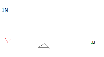

I mean, in the case I show in this picture:
What is the moment arm of the 1N force about the green point u?
If I follow the rule which says you need to know the minimum distance between the line of application and the point, the arm would be the hole length of the seesaw.
If I consider that there is a fulcrum in the midle point, the arm would be only half the length of the seesaw, and that is what I think it´s the correct answer, Isn´t it?
The moment of the 1N force about u involves the whole length. The fulcrum provides a moment in the other direction.
I see, I wasn´t using the correct application point, I recalculated everything and I found the same as you.
Very interesting, so only to check if now it´s clear. In this case:
IF the problem asks you to find the equivalent force-couple of the 1N force, you can forget the fulcrum, the problem is not asking the real couple of the system, only the equivalent to the 1N force at point u.
IF the problem were asking us to calculate the total forces and moments on the system we should include everything in that calculation the 1N force and the fulcrum.
The total force would be 0, since the normal of the fulcrum equals the 1N force.
The system only rotates around the fulcrum with a total moment= 1N*L - 1N*L/2=L/2 N*m is the answer, counter clock wise. L is the length of the seesaw.

jonjacson said:
... since the normal of the fulcrum equals the 1N force.
Not in general. Are there no other forces in this picture? No acceleration? What here has mass: the plank? u?
I went too fast with that. You are right, it´s not general, if the bar is massless and the point u weights 1N, the fulcrum must react with 2N to get equilibrium.
