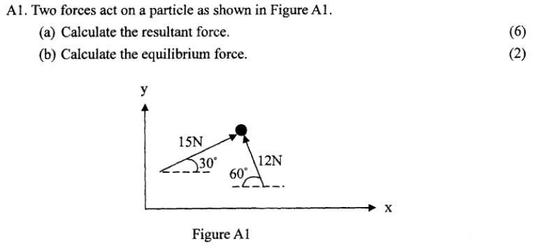

A1(a) R= 19.21∠68.7o N
(b) E = 19.21∠-111.34o N or = -19.21∠68.7o N <--- Is't either one answer is correct or not? If not, which answer is correct and why? Thanks.

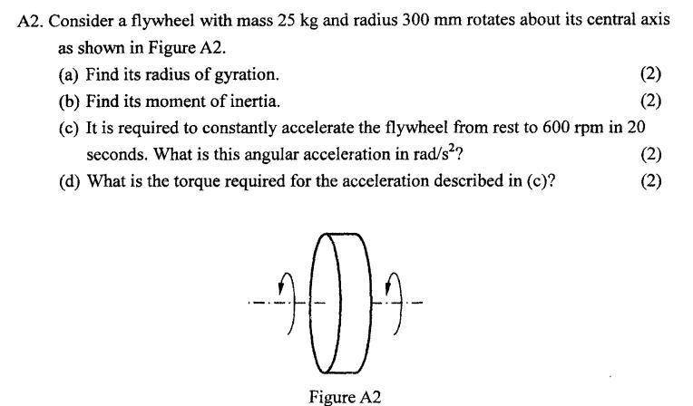

A2(b) I = 0.5mr2 = 1.125kgm2
A2(a) k=(I/m)1/2 = 0.212m
A2(c) αt=ω, α = 3.14 rad/s2
A2(d) T=Iα = 3.53Nm
I can't gain the answer of A2(a) first. I use the A2(b) answer to help me to gain the A2(a) answer. So, the step of my calculated order is A2(b) -> A2(a) -> A2(c) -> A2(d). Is't correct?

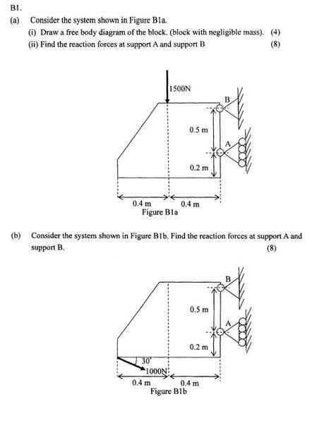

B1(a)(ii) RBY = 1500N
sum of force and moment = 0
RA = 1200N (toward left)
RBX = 1200N (toward right)
B1(b) RBY = 500N
RA = 2012.4N (toward left)
RBX = 1146.4N (toward right)

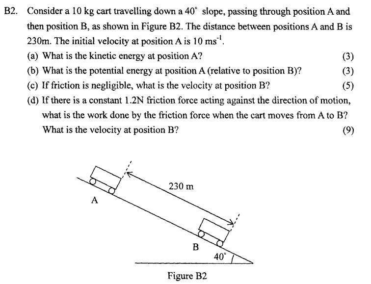

B2(a) KE = (0.5)(10)(100) = 500J
(b) PE = (10)(9.81)(147.8) = 14503.1J
(c) v2 = {[(500 + 14503.1)x2]/10}0.5 =54.8m/s
(d ) WD = 1.2(230) = 276J , v= {[(15003.1-276)x2]/10}0.5 = 54.3m/s

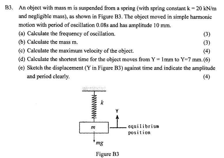

B3(a) n = 1/0.08 = 12.5Hz
(b) m = (0.08/2π)2(20x103) = 3.24kg
(c) ω = 2π(12.5) = 78.5rad/s, v=78.54x0.01 = 0.785m/s
(d) f = 78.542(0.006) = 37.01m/s2 , T = 2π(0.006/37.01)0.5 = 0.08s
(e) I can't do this part, may you help me, please?

  • Figure A1: x-y axes with a particle at the origin of two forces; 15N acts up and to the right at 30° above the horizontal, and 12N acts down and to the right at 60° below the horizontal from the particle.
  • Figure A2: diagram of a flywheel, a wide cylindrical disc on a central axle, with curved arrows showing rotation about the axis.
  • Two statics diagrams labelled Figure B1a and Figure B1b: a block with a 1500N downward load, pin supports A and B on a wall, 0.5 m and 0.2 m vertical dimensions, 0.4 m and 0.4 m horizontal dimensions; B1b has a 1000N load at 30 degrees.
Questions of pictures B2 and B3
  • Diagram of a 10 kg cart on a 40° slope, with positions A (upper left) and B (lower right) marked 230 m apart along the incline, and the text of question B2 above it.
  • Figure B3: a mass m hanging from a spring k attached to a ceiling, with an upward Y axis beside the mass marked equilibrium position and a downward arrow labelled mg.
