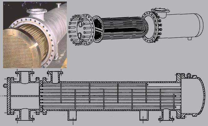

You've been asked to draw a P&ID for a water heating system. 20 tonne/hr of water is to be pumped from the atmosphere into a heat exchanger at 1.6 MPa. Steam is being used to heat the water to 145 C. The heated fluid is then stored in a vessel, which is designed to hold 4 minutes of flow. Show all your calculations.
Where ##Q## is the volumetric flow rate:
1)##Q = Av## where ##A## is the cross sectional area of the pipe and ##v## is the velocity of the fluid through the pipe.
2)##Q = \frac{ \dot{m}}{\rho} ## where ##\dot{m}## is the mass flow rate and ##\rho## is the density of the fluid.
3)The speed of water through pipe can be approximated as 2 m/s.
Well, 20 tonnes/hr is equal to 20(1000)/60(60) kg/s. Thus: $$\dot{m_{water}} = 5.55 kg/s$$
Dividing this by the density of water, the value of ##Q_{water}## was found to be 5.55 x ##10^{-3}## m^3/s.
Using this, the value of the pipe diameter can be calculated to be 0.059 metres by using equation (1). Now, I was wondering, does the heating by the steam affect the value of the flow rate out of the heat exchanger? If not, the capacity of the vessel can easily be calculated by multiplying the surge time (in seconds) by the flow rate.
Finally, how do I incorporate the values of temperature and pressure into my calculation? I'm not really sure what they're required for.
Also, how would I go about sizing the size of the pipe used to deliver the steam? Or is that even possible with the information required? Thanks in advance and if you need any clarification on the question, let me know.
Also, this is my first post, but I still know that I won't be told the answer. Just a help in the right direction would be handy. Thanks.

Hi Undergrad1147. Welcome to Physics Forums.
The first thing you need to come to grips with is that this design is going to be an evolutionary process, with lots of alternative designs and concepts you would like to consider. All you know so far is that there is going to be a pump, a heat exchanger, and a surge tank. Before you start calculating pipe diameters and flows, you need to first focus on the thermo. What is the vapor pressure of water at 150C. This will tell you the minimum pressure needed in the heat exchanger to keep the water from boiling. How does the vapor pressure at 150 C compare with the inlet pressure to the heat exchanger. You now know the maximum pressure drop you can tolerate on the water flow side. What is the temperature of saturated steam at 1 MPa? Will this be high enough to heat the water to 150 C? These are some of the things you need to be looking at before you start designing. What is a reasonable value for the inlet temperature of the water from the environment? Should you consider a range of values?
Chet

Nice job. Now you're ready to start designing the heat exchanger. Have you learned about the different types of heat exchangers in your class or from your book? What design of heat exchanger do you think would be appropriate for this application? Please say in words how you would begin to go about designing a heat exchanger of this type. Meanwhile, to help you think about this, from the information you concluded above, you have enough information to determine: (a) the heat load of the heat exchanger, (b) the amount of 180 C steam flow necessary, (c) the temperature difference at the water inlet, (d) the temperature difference at the water outlet, and (e) the log mean temperature difference.
The heat exchanger you design must have enough heat transfer area to allow the heat load to be transferred, and it must also have a low enough pressure drop to prevent the water from starting to boil. These are some constraints that you can use to help you design the heat exchanger.
Chet

Good. You're doing very well so far. Shell and tube looks like a good choice. We'll put the water through the tubes, and the steam through the shell.
That being said, I think I have seen some equation that relates the area of HE to the heat load or temperature difference, something along those lines. Does such an equation exist?
Yes. We can get to that shortly.
a) Well, the head load will be the difference in rate of energy in, i.e. from the steam and cool water streams, and the hot water stream out. Is this correct?
Yes. Very good.
b)You can calculate the amount of energy per second required to heat the water from 20 C to 150 C using Q = ##\dot{m}## * c * (T2 - T1), yes? Then using this values and dividing it by the enthalpy of condensation of the steam, you can calculate the amount of steam flow required. Does that sound correct?
Excellent. So, what numbers do you get in MJ/hr and kg/hr?

Bird has dimensionless correlations for calculating h as a function of the reynolds number and the prantdl number. The book also has typical ranges for h for condensing vapors, and for convective heat transfer of water flow in tubes. You might start out by using a mid-range value from the typical range to get you started.
What would you consider a reasonable length for the heat exchanger: 0.1 - 1 meters, 1 -10 meters, 10 - 100 meters? I know what range I would choose to start with.

I'm not sure about your question about using the water from the condensing steam. The problem statement doesn't say anything about this. It all depends on what this plant is being used for. Since your instructor made up this problem, it doesn't correspond to any real situation. But, if the water being heated was really a process stream that contained dissolved chemicals that are being processed, you wouldn't normally mix the steam with the process stream (since the steam might not be as pure as you would like it).
Undergrad1147 said:
Actually, I just got my hands on Transport Phenomena an had a quick look at chapter 14. While most of it is quite out of context, as I haven't studied Transport Phenomena before, I found the table of heat transfer coefficients. Is what we have in this case, Forced Convection? (Seeing as there's a pump involved.)
If this is the case, for water, the value of h ranges between 500 and 10000 W/m^2.K. This is a fairly large range. How would I go about choosing a good estimate for h? From engineeringtoolbox.com, 680 seems to be a good choice if the material of construction is SS.
Well, I would have chosen a value close to the low end also, so the 680 is fine with me. Don't despair. Nothing is carved in granite yet. We just need something to get us in the ballpark. Then we will be refining the design gradually until we arrive at something that we are comfortable with. Like I said in my first post, design of a heat exchanger is an evolutionary process. So, for the first crude approximation to the heat exchanger design, you will be using the 680. As you refine the design, you will be using Eqn. 14.3-16 of BSL to estimate the heat transfer coefficient on the liquid water side more accurately.
To calculate the heat transfer area using the 680, you're going to need to use the average temperature driving force in your overall heat transfer equation. As we said, the driving force at the water inlet end is 160 C, and the driving force at the outlet end is 30 C. If you used the arithmetic average driving force, you would use (160 + 30)/2 = 95 C. However, the solution to the differential equations for a heat exchanger tell us that we should be using the so-called logarithmic mean driving force: (160 - 30)/ln(160/30) = 78 C. So that's what you should consider using. With these values, what do you get for your starting estimate of the heat transfer area in your heat exchanger?

So, the heat transfer area is 85 m^2. Would this be considered large or about the norm for the sort of process in question? Can't really tell myself as I don't have too much experience with this sort of calculation.
Seeing as $$A = N\pi DL$$
Where N is the number of tubes, L is the length and D is the diameter. I assume that two of the above variables are arbitrary and then we can calculate the third, yes?
Undergrad1147 said:
Sorry about those blunders. I ended up trying to fly through the calculation and obviously wasn't taking much care.
In a way. You still have to satisfy the constraint on the pressure drop, which places a constraint on these variables.
Start thinking about what the physical package of the heat exchanger might look like. Look at the room that you are sitting in. Suppose you would like the heat exchanger to fit into that room. From the outside you are going to see the cylindrical shell, which you don't want to be as long as a football field, and you don't want to go from floor to ceiling. Have you ever seen a shell and tube heat exchanger? What type of length to shell diameter ratio do you remember these things having? You need to squeeze all that heat transfer area into a package that size. Play around with the numbers for N, L, and D. Recognize that you have to leave some space between tubes to allow the steam to go through the shell. That needs to be taken into account in getting the shell diameter. Think about these things, and see what you come up with as your zero order approximation to the heat exchanger design. It's not carved in granite yet, and there is no exactly right answer.
