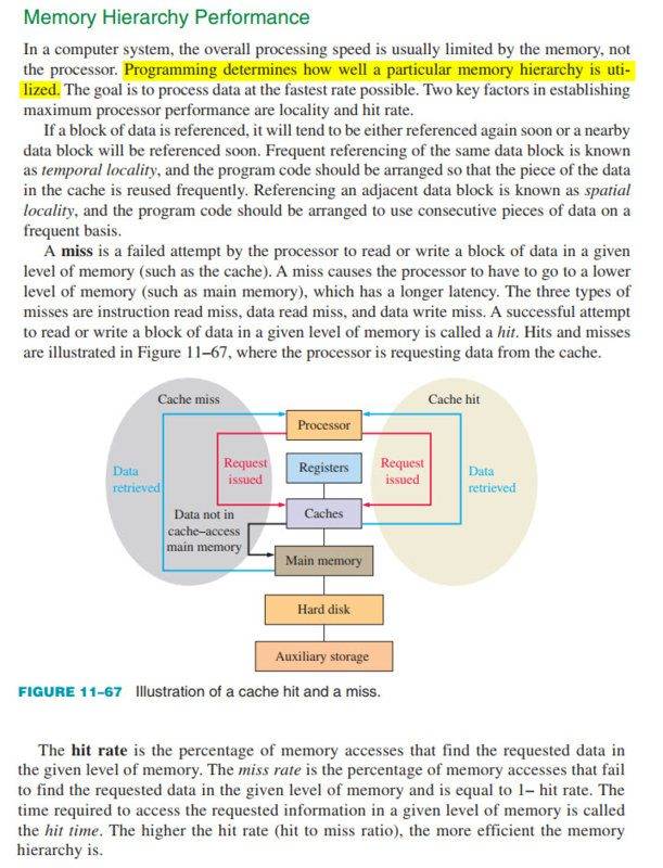

Hi,
Please have a look on the attachment. It says, "In a computer system, the overall processing speed is usually limited by the memory, not the processor. Programming determines how well a particular memory hierarchy is utilized. The goal is to process data at the fastest rate possible."
I understand that programming is actually a set of directives for a computer hardware to take 'logical' steps to get a certain job done. It does make sense that if if there is a useless redundancy in those logical steps then it wastes time as well as storage of a computer system. For example, if there are three positive numbers A, B, and C, and if A=B and B<C, then obviously A<C and you don't even need to make a comparison between A and C. But if the logical step of comparing A and C is taken then it would waste storage as well as processing time.
I'm not sure if what I said above is completely correct, I was only trying to convey how I think of it. I have worked in C++ and many a time, you just write a code and a compiler translates your code into machine language. I'd say that how well a compiler handles its translation job also greatly determines how well a particular memory hierarchy is utilized. Do I have it right? Or, perhaps a compiler translation also plays a role but not as much as the programming itself. Here, I'm think of programming as 'high level language' programming.
Could you please help me to get a better understanding of it? Thanks a lot.
What this quote is talking about is the fact that, in modern computer systems, the CPU is faster than the memory is, so any program will spend most of its time waiting on memory to be read from or written to, not waiting for the CPU to compute the next instruction. So there is much more speed gain to be had by optimizing how programs read from and write to memory, as opposed to optimizing how programs execute CPU instructions.
This is true, but it's not the kind of efficiency the attachment you give is talking about. Eliminating redundant logical steps will make the program not need to execute as many CPU instructions to accomplish the same goal; but, as above, programs don't spend the majority of their time waiting for the CPU to execute instructions, so the speed gains to be had by eliminating redundant logical steps are limited.
Yes, that's true; how a compiler translates source code into machine code can have a huge effect on how efficiently the program reads from and writes to memory.

A useful perspective on memory utilization is to consider memory access as I/O (input output). Accessing a data structure loaded into main memory is faster than access to intermediate memory and much faster than accessing storage. A similar paradigm applies to operating system performance. Program set instructions loaded and resident perform faster than program sets waiting on a queue and much faster than reading from storage.
If the above is reasonable and accurate, then code/memory optimization depends strongly on data structure -- including variables, objects, and allocations -- choice and design within the available computer architecture.

PeterDonis said:
Where does this attachment come from? Can you give a reference? A link?
Thank you.
It comes from a book Digital Fundamentals by Thomas Floyd.
Some programs are IO intensive: some others are memory intensive, some depends on raw calculating capacity. (Many others are just a pile of rubbish.) Optimization - fitting the SW to get the best performance on a given HW - is a difficult topic, always depends on the actual software.
Compilers (and their different optimization levels) do have an effect, but it is not exclusive to memory.
Don't limit the topic only on memory.
