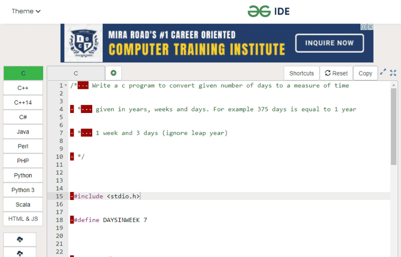

When I tried to run this c program in online IDE, it showed several compiling errors. https://ide.geeksforgeeks.org/?ref=ndm

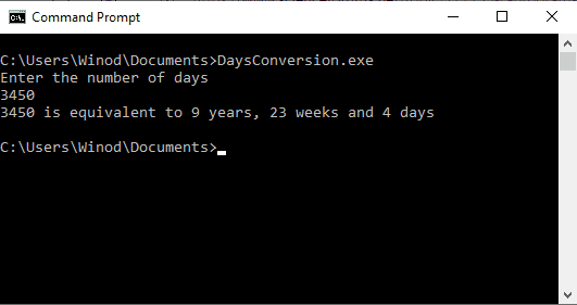

The result of your suggestion is as follows:

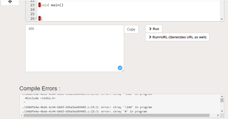

After I fixed one syntax error, I was able to get the program to run in the online IDE.
This line - #include stdio.h
should be written as #include <stdio.h>
When I ran that code, I entered 300, and the program reported "300 is equivalent to 0 years, 42 weeks and 6 days".

Would you tell me which online IDE did you use successfully?
My use of online IDE gave me the following result:
See all those characters highlighted in red? Why do you think they are highlighted in red?

I don't know the meaning of …, .., . in red colour in the program I put in the online IDE. In my opinion, these red dots represents errors. But how to debug this program is my problem. Do you know it's solution? :confused::sorry:
You could try deleting the errors (were they there in the code you copied or do you think they have appeared as part of the copying and pasting process?)
Also note that the Notepad doesn't work well with text copied from a web page, use a proper text editor designed for code like Visual Studio Code.

These errors were appeared as a part of copying and pasting process.
