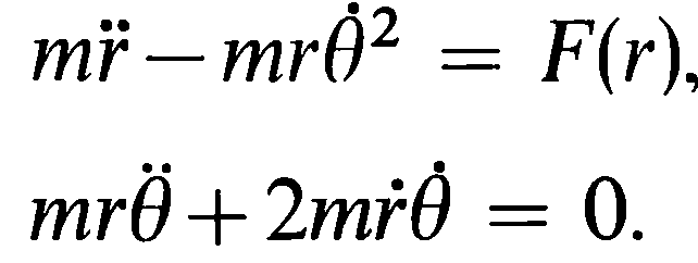

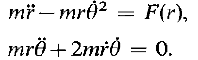

1. The derivation
In a 3-dim space,a particle is acted by a central force(the center of the force fixed in the origin) .we now take the motion entirely in the xy-plane and write the equations of the motion in polar coordinate
Two equations in polar coordinates: m r double-dot minus m r theta-dot squared equals F(r), and m r theta double-dot plus 2 m r-dot theta-dot equals 0.
how can i derive from these equation that
T(kinetic energy)+V(potential)=E=
Handwritten-style expression for kinetic energy in polar coordinates: (1/2)m r-dot squared + (1/2)m r squared theta-dot squared + V(r).

Read http://leandros.physics.uoi.gr/cm1/book-cm/ch6.pdf, for example.
You need to integrate both equations. The integral of the second one is conservation of angular momentum, that of the first one is conservation of energy.
