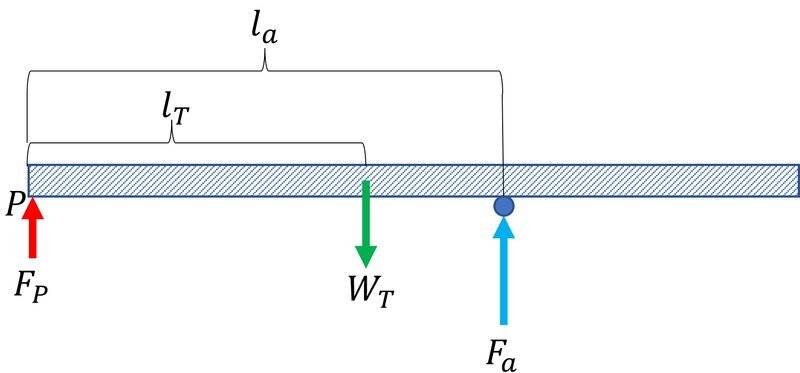

From a force balance we have that:
$$F_P = f W_T $$
$$ F_a = \left( 1-f \right) W_T$$
Where ## f## is the design fraction of the trailer ( trailer + load ) weight supported by the tongue, and ##F_a## is the reaction force at the axle:
If we sum torques about ##P##
$$ \circlearrowright ^+ \sum \tau = l_T W_T - l_a \left( 1-f\right)W_T = 0 \implies l_T W_T = l_a \left( 1-f\right)W_T \tag{1} $$

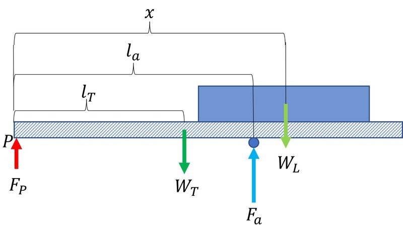

Performing the same analysis for a loaded trailer:
$$ F_P = f \left( W_T + W_L \right) $$
$$ F_a = \left( 1-f\right)\left( W_T + W_L \right) $$
$$ \circlearrowright ^+ \sum \tau = l_a \left( 1- f \right) \left( W_T+W_L\right) - l_T W_T - x W_L = 0 \tag{2}$$
where ## x ## is the horizontal distance from ##P## to the load center of mass.
We can then substitute our result for ## l_TW_T## from ##(1) \to (2) ##:
$$ l_a \left( 1- f \right) \left( W_T+W_L\right) -l_a \left( 1-f\right)W_T - x W_L = 0 $$
And after simplification, the distance to the load center of mass ##x## required to preserve the design fraction of total load ##f## supported at ##P## is given by:
$$ \boxed{ x = l_a \left( 1-f \right) }$$
For this problem the OP has referenced ##f## as:
$$ 0.10 < f < 0.15 $$

erobz said:
https://www.physicsforums.com/attachments/304346
This diagram has the CoM of the load behind the axle: that is not a good idea. Your workings are also complicated by the fact that you are using the subscript T to mean both 'tow hitch' (as in ## f_T ## and 'trailer' (as in ## W_T ##). The answer is the same as already posted in #14 and #12 which I will quote again here:
pbuk said:
$$ \frac{(L-x)}{L} = \frac{W_t}{W}$$ which in words is "if you want X% of the weight on the hitch then put the centre of mass X% [of the distance of the hitch] forward of the axle".
I've added a disclaimer at the top, and I've changed ##F_T## to ##F_P##.
Thank you for the critique.
