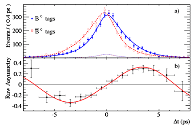

One nice example is shown in this beautiful plot from Babar:
The idea is that you have the production of [itex]B_{\text{tag}}^0\bar{B}^0[/itex] mesons... and you measure the [itex]B_{\text{tag}}^0[/itex] meson's evolution over time (compared to the [itex]\bar{B}^0[/itex])..The nice thing with the neutral B mesons is that there is a possible transition [itex]B\rightarrow \bar{B} \rightarrow B^0 \rightarrow ...[/itex] etc. Now you can measure how much time it takes the [itex]B_\text{tag}^0[/itex] to decay (and also see if it decays as a [itex]B[/itex] or [itex]\bar{B}[/itex]) ([itex]t[/itex] or [itex]t'[/itex] respectively) and compare it to the time of decay of [itex]\bar{B}^0[/itex] ([itex]\bar{t}[/itex]).
Then you have this variable [itex]\Delta t = \bar{t} - t[/itex] (blue markers) or [itex]=\bar{t}-t'[/itex] (red-markers) (so if the tag decays second, the time difference is negative).
The fact that the [itex]B^0_\text{tag}[/itex] and [itex]\bar{B}_\text{tag}^0[/itex] have so different [itex]\Delta t[/itex] (their asymmetry is shown in the bottom panel) is obviously due to different behavior between matter [itex]B^0_\text{tag}[/itex] and antimatter [itex]\bar{B}^0_\text{tag}[/itex]
