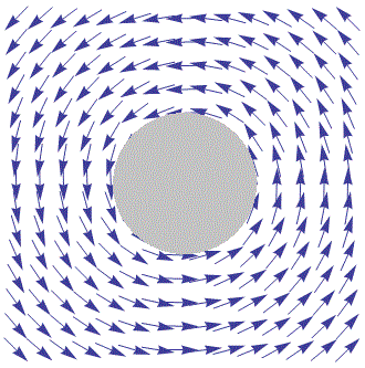

OK, does this picture represent the field and the sphere, (i.e., a cross-section through the sphere parallel to the xy plane)? This assumes the components given in the OP are Cartesian and ##\phi## is azimuthal angle.
Clearly this field doesn't represent an electrostatic field, as ##\vec{\nabla} \times \vec{E} \neq 0##. It would have to be generated with a particular time-varying magnetic field such that ##\vec{\nabla} \times \vec{E} = -\frac{\partial \vec{B}}{\partial t}##. Don't know if this is possible. [EDIT: I guess you could have a magnetic field in the negative z direction that increases proportional to time and has a magnitude that falls off inversely as the distance from the z-axis.]
