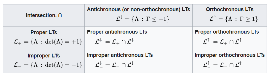

PS: I cannot wait to dive into this! 😍 Mmm I see that the full Lorentz Group is made of the union of four disjoint sets
But first things first!
When we say the Lorentz group is a group, it is assumed that the binary operation is matrix multiplication. The set of all invertible matrices is a group, so we are really looking to show that the Lorentz group is a subgroup of that, which is why we have only a few things to prove. Although, actually, it's not that much less to do.
Note that the binary operation is not the inner product. A group is an algebraic structure. Some groups also have an analytic or topological structure. This requires some definition of magnitude or distance - metric, norm, inner product - or, more abstractly, some concept of open sets (which is the more abstract topology). This is the basis of continuity, differentiability and calculus.
For example, the group of boosts and rotations is a normal subgroup of the Lorentz Group. Normality is an algebraic property. It is also a connected subgroup. Connectedness is an analytic or topological property.
