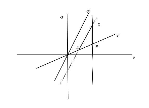

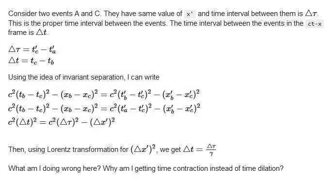

  • One participant asserts that the time between events in the unprimed frame is represented by ##t_c-t_a##, indicating that event B is irrelevant to this calculation.
  • Another participant corrects the notation, stating that the correct expression for the time interval is ##\Delta t=t_c-t_a##, rather than involving event B.
  • Multiple participants express frustration regarding the use of images for equations, suggesting that LaTeX code should be used instead for clarity and ease of quoting.

The time between the events in the unprimed frame is ##t_c-t_a##, the event B has nothing to do with it.
Also, please do not post pictures like this. Type it into the post instead, the images are impossible to quote.
##\Delta t=t_c-t_a##, not ##t_c-t_b##.
If you generated the image of text and equations using LaTeX, simply paste the LaTeX code into your post and enclose it between $$ delimiters on each end. For more information about using LaTeX here, see https://www.physicsforums.com/help/latexhelp/ .
