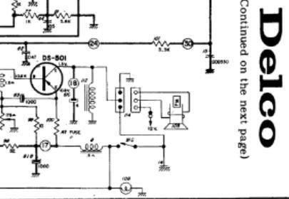

If it's the "Sonomatic", ie no 'Wonderbar' motor driven tuning, it's probably a Delco 728934
and from a search, an antique radio forum said Sam's Photofacts AR30 repair manual covers it. Ebay has a few listed. But you have to be careful for misinformation abounds.
Probably there's a Delco manual out there someplace.

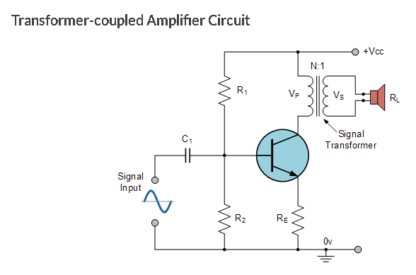

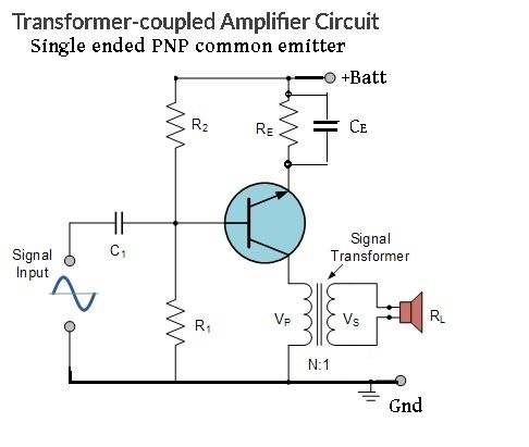

Do you understand transistor biasing ?
see https://www.electronics-tutorials.ws/amplifier/amp_5.html
ten volts across RE is too much for a 12 volt supply..
C1 who blocks DC from previous stage might be leaky,
Biasing resistors R2 or RE which establish quiescent operating current might have drifted high.
R1 who with R2 makes a voltage divider to set base voltage could be low, but carbon resistors usually fail high.
You need your schematic.
Or you'll have to trace out your circuit board and draw a schematic of the part under study
so as to find physically where to measure

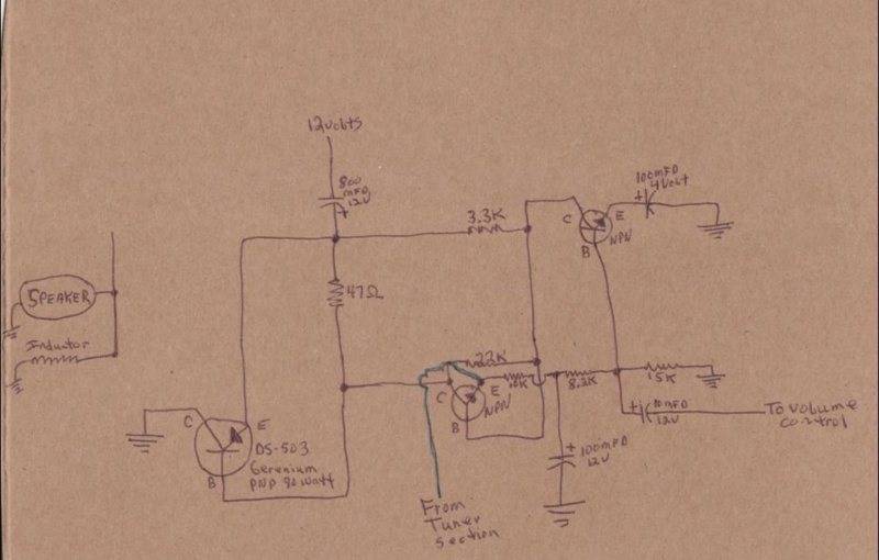

Draw one and write on it voltages at E B and C .
old jim

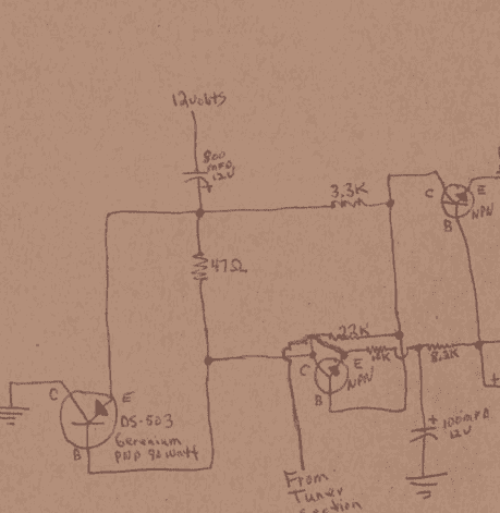

Of course if that output transistor is a PNP
the circuit will be upside down from what i pasted above,
with base and emitter near 12 volts and collector near ground.
You already measured base and emitter near 12 volts - what does collector show ?
Troubleshooting is like working a jigsaw puzzle .
You establish known facts one by one , building a mental picture from them.
Once you've established what is that output transistor, NPN or PNP, germanium or silicon,
you can judge whether your voltages make sense.
So that ought to be your first "fact" to establish.
Voltages at E B and C will be a clue.
Values of the resistors will tell you what the designer had in mind.
Go man, Go !

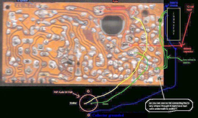

I was checking to see if speaker wire is connected to any thing I took picture and drew every thing paper but I don't see no connection from collector of output transistor to speaker wire. I was always looking at the transformer and I drew it in diagram as it is hooked up with one wire going to chassis ground and another wire going to electrolyte capacitor ground and the the other two wires are going thru a sleeve and get connect to speaker wire/ Maybe I am not understanding the electorate capacitor right I thought the four pins coming out one is 800 mfd another 400 mfd and another 100 mfd and I thought the fourth pin is ground where the transformer get hooked. I took my speaker wire and connected it to collector of output transistor and I got it to play for a little while then it cut out again
Shouldn't be one. Collector drive primary as in that tutorial.

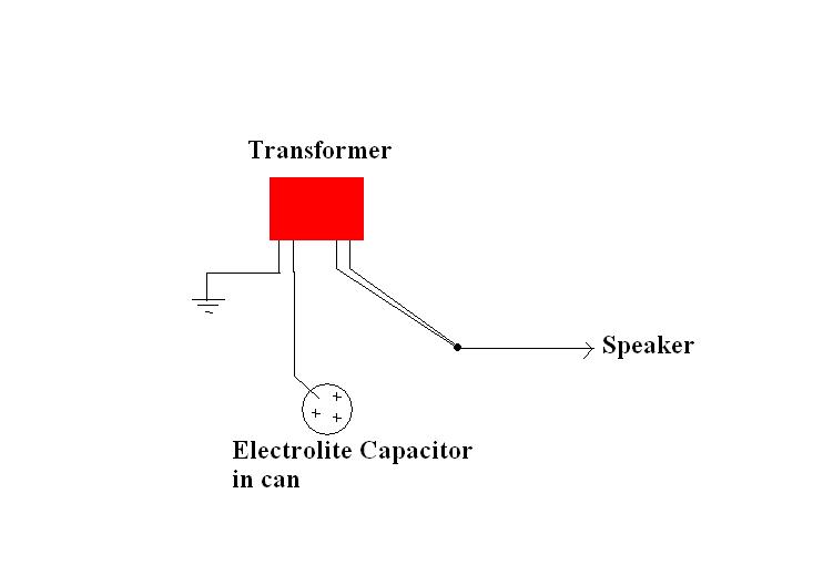

Both wires to ground can't work. Might one of those wires go to the collector(case) of the TO3 transistor instead ?
That probably should have wrecked the output transistor and the speaker.
Take some pictures and post them ?
What is part# of output transistor?
What are voltages at emitter base and collector of output transistor? Measure to 1/10 volt, include polarity with black voltmeter lead to chassis gnd. .
your photo doesn't show, try pasting it into Paint and see if anther format will show up.
Your schematic doesn't show a transformer with four wires but only an inductor with two and it's in parallel with speaker
One speaker wire goes to ground
other one goes to junction of collector , inductor and a capacitor.
EDIT (late entry) That the speaker is connected to output transistor collector makes my remark yesterday about wrecking parts , well, just plain WRONG.

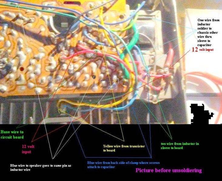

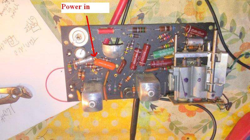

I drew out all wires I disconnected on paper and even took picture when I am all done pin on board where speaker and inductor wire is soldier on goes no where could have been wire underneath that fell off but haven't found any yet. I would think only logical place to connect speaker is to E of Ds-503. I drew up a partial diagram how it is wired the 12 volts goes around capacitor not thru it..

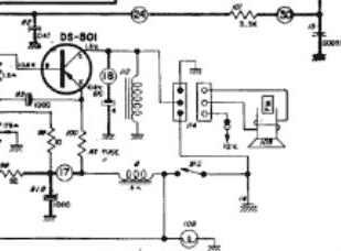

You're making progress.
Focusing on just the output stage
E ? perhaps C ?

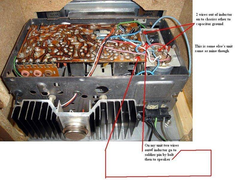

I drew it right c is the case and case is bolted to aluminum heat sink and this is mounted to chassis no plastic spacers around bolts just seems like you need to connect speaker wire to emitter. I have picture before I unsoldiered any thing and picture of board. And after first soldering every thing back the first time I did pickup sound after connecting 8 ohm speaker to emitter or yellow wire.
Your friend's picture shows plastic spacers
yours doesn't look like the same heatsink
and i think you have already noticed that.
If your "inductor " has four wires it is almost certainly a transformer.
Is there a part number on that output transistor?
Is there a mica washer underneath , between it and the heatsink?
