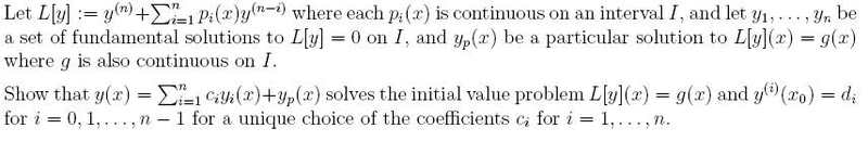

The discussion focuses on proving the uniqueness of the complementary solution, denoted as y_c, in the context of the differential equation L[y]=0. The user successfully demonstrates that y_c satisfies the equation for a unique set of initial conditions using the Wronskian and invertible matrix proof. However, they seek assistance in extending this proof to the general solution y(x) = y_c + y_p, where y_p represents a particular solution. The urgency of the homework deadline emphasizes the need for clarity in the proof process.
