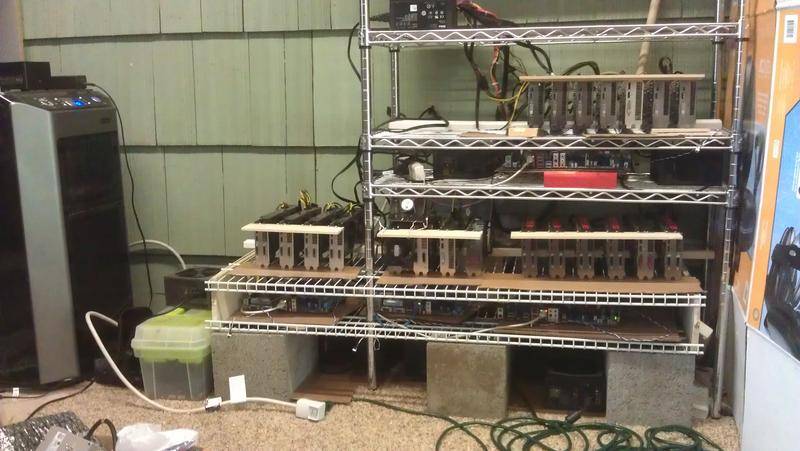

This is what I was measuring though,
Lots and lots of watts so of course lots and lots of heat. The whole setup is between 3-4 kW IIRC. So basically its a 3.5 kW heater. Great in the winter, tough to keep under control in the summer.

Wow. Other than a heater what are you using that for?
$$$$ (mining bitcoins) Its been real profitable so far, I have very cheap electricity. The market is changing though and I will be selling it off soon.
