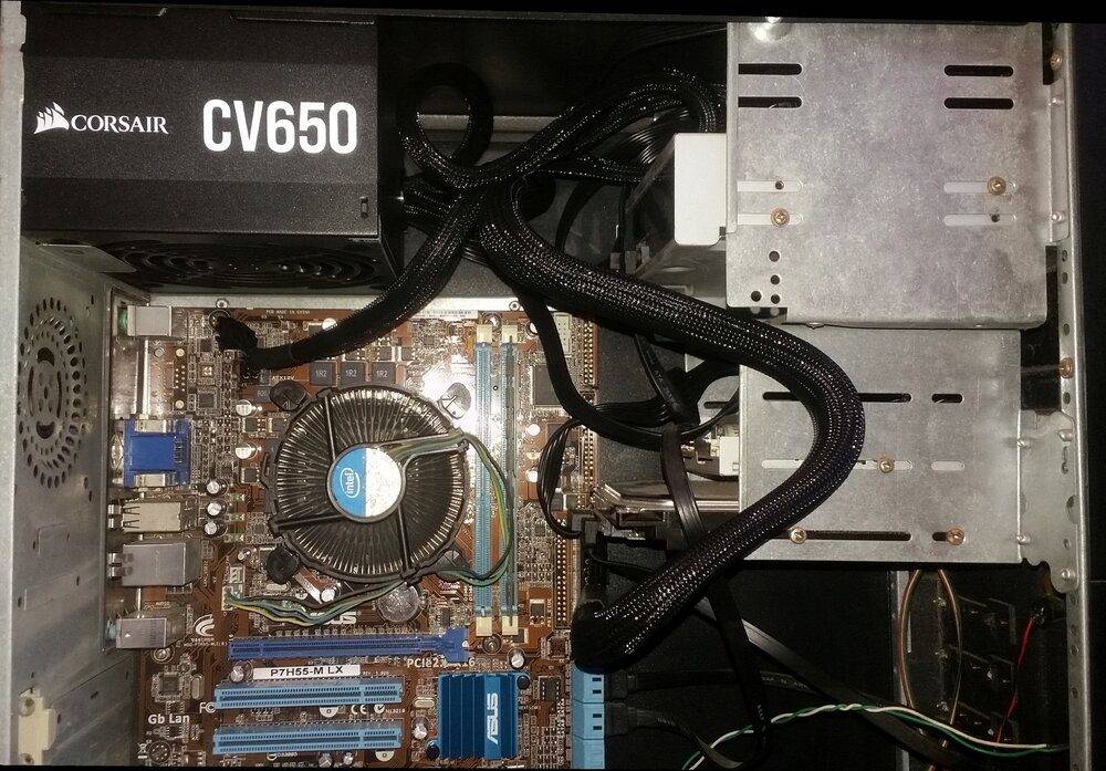

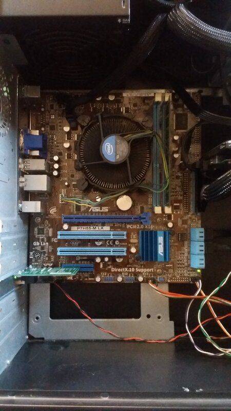

Our Windows 7 32-bit desktop PC is fitted with an Asus P7H55-M LX motherboard. It was working fine till yesterday evening, but from this morning, it won't turn on. (By this, I mean that it is not even starting the boot; the fan on the processor won't run.)
My first guess was the PSU. So I unplugged the 24-pin ATX connector, and connected the green and one black terminal. The SMPS turned on properly with its fan running.
I checked the voltage of the different terminals with my multimeter. The results were as follows:

On checking with the internet, the results seem acceptable, so the SMPS is working fine.
There is a green LED on the motherboard labelled "F_PANEL". In the past, when the SMPS was connected to the AC mains, this light would glow steadily even before we switched on the PC using the power button. Now, however, this LED is blinking:
I have tried shorting the power button terminals on the motherboard, and also tried to switch on the PC without the RAM. Nothing works.
I need some help in figuring out and solving the problem. If the PSU is fine, then is the motherboard faulty? How can I confirm that it is faulty?

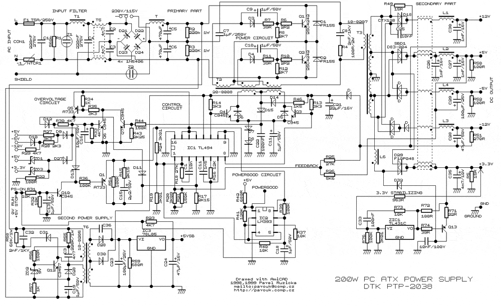

In the first post you stated that the supply came on for testing when the Green and Black wires were jumpered on the 24-pin connector.
Try jumpering those pins with the 24-pin connected to the motherboard. If something smokes, you've found the problem.
It could still be either the supply or the motherboard that is bad.
The supply has a current limit circuit built-in so it shuts down on an overload. If there is a short on the motherboard, the supply will immediately shut down.
The supply also checks that each of the output voltages is within the proper range. If all are good the PowerGood (PWR_OK) signal is sent to the motherboard, 24 pin connector, pin 8, Gray wire, +5V if OK. Without it, nothing powers up.
Here is a schematic of a 200W ATX power supply.
The power-on (PS_ON# active low) input is at the left edge, about 1/3 up from the bottom.
The POWERGOOD output is lower center, about 1/3 up from the bottom.
Line input is at top left, and outputs along right edge.
PowerGood sensing is at left center (just above PS_ON) and labeled OVERVOLTAGE CIRCUIT.
5V_StandBy is at bottom left.
The center is taken up by the switching logic and drivers feeding the power transformer T3.
edit: corrected PS_ON# input to show it is normally hi, active low

It seems that the problem is with the PSU after all. After you said, I checked the gray wire, and it gave 40 mV. In addition, Dad's colleague has checked the motherboard and found it everything in working condition - from the CPU fan to the RAM.

Update:
We bought a SMPS from Amazon India: https://www.amazon.com/gp/product/B07YVWMV5D/?tag=pfamazon01-20. It was a bit costly, but other low cost PSUs had very bad reviews (getting burnt within two days, shorting the motherboard, etc.), so we decided to buy this one. It arrived today, and upon plugging in, the PC has sprung back to life!
Thanks everyone for your advice/help, especially @Tom.G, who pointed out that even if all voltages are up to the mark, the PWR_OK pin needs to give 5V to indicate the the PSU is working properly.
