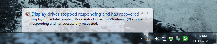

4. Often the monitor goes black, and then the display comes back, with the following notification:​

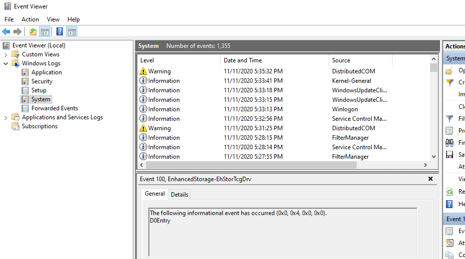

Have you looked at Event Viewer? It's one of the Windows Admin tools.
Windows Event Viewer showing the System log with 1,355 events, listing warning and information entries with date, time and source columns.
Look for any events with a red circle that says "Error" or "Critical Error" that seem to have something to do with the graphics adapter. Besides the System logs, also look in the Application logs.

It could be that the graphics board is not fully seated in its motherboard socket. Or since it occurs after a half hour, check the fan and heatsink on the graphics board.
Try re-installing the video driver - some of them are very fussy and prone to crashes. You could also see if there is a newer (or even older) version available.
Another possibility is some other recently installed software is not compatible the the specific video driver version.
And another possibility is there is some software (possibly, but not necessarily, malware) running in the background that is interfering. When the problem occurs, bring up the Task List and look for either something unusual or for something using most of the CPU time.
Good Luck. These things take some sleuthing.

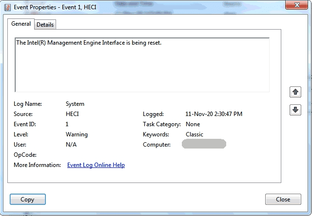

I see the following errors and warnings that occurred on that day when the display went black:
System:
Windows Event Properties dialog for Event 1 from source HECI, a Warning in the System log, with the message 'The Intel(R) Management Engine Interface is being reset.' Logged 11-Nov-20 2:30:47 PM.
The above warning has been recorded at least eleven times that day, at a varying interval of a few seconds to few minutes.

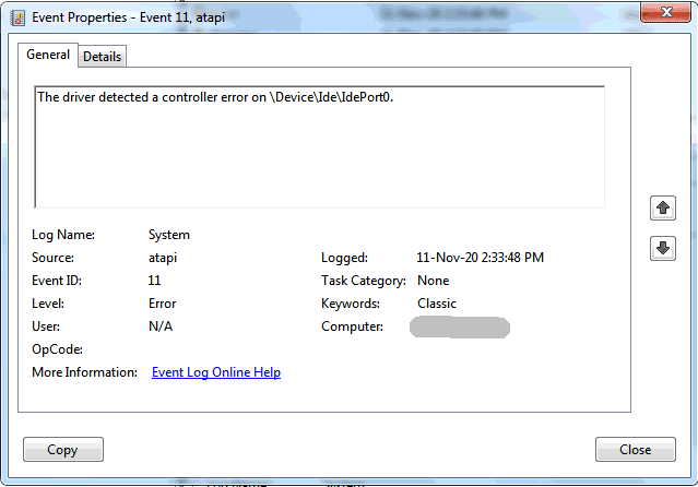

Windows 7 Event Properties dialog for event 11, source atapi, level Error, logged 11-Nov-20 2:33:48 PM, with the message: The driver detected a controller error on \Device\Ide\IdePort0.
The above error has been recorded only once.

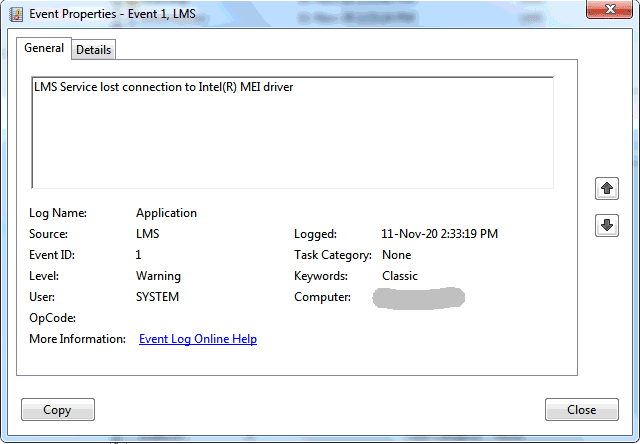

Application:
Windows Event Properties dialog for Event 1 from source LMS, Level Warning, reading: LMS Service lost connection to Intel(R) MEI driver. Logged 11-Nov-20 2:33:19 PM.
The above warning has been recorded almost twelve-thirteen times that day.
What do these indicate? I searched for "Intel Management Engine Interface being reset", but couldn't find anything that tells what to do to solve the problem.

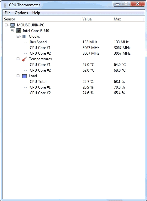

You've put forward an interesting point. I downloaded one of the programs listed here to find the CPU temperature. This is what it shows:
Screenshot of the CPU Thermometer window listing an Intel Core i3 540 with clocks, temperatures and load readings for each core.
The temperature of the CPU decreases if no work is done and the PC is kept idle. For example, when I downloaded the software for the first time, the temperature was about 50°C. As I activated TeamViewer to control the PC from my laptop, the temperature started soaring, and reached 60°C. Then I left it idle for about half an hour, and now the temperature is 40-50°C.
The PSU cooling fan has it's outlet inside the CPU cabinet, so I have already installed a chassis fan. It is, however, possible that Dad's colleague did not put any thermal paste over the microchip before assembling the heat sink over it.
If this is the temperature of the processor, it's OK, but if this is the temperature inside the case, not the processor, it could be that the processor is getting too hot.
This website -- https://www.cputemper.com/maximum-and-normal-cpu-temperature/ -- says that the CPU temp at idle should be 45 - 55 deg C, and but shouldn't go beyond 70 - 80 deg C. Does your computer report the CPU temperature or are you just measuring the temp inside the case?
If the temps you are seeing aren't the CPU temps, lack of thermal paste could be what's causing the problem. In any event, make sure that all case vents aren't plugged up with anything.
I am using a software program to find the temperature; I am not measuring it directly. In Windows, the BIOS reports the temperature, but a separate program is needed to read it — Windows does not itself show the temperatures.

The EventViewer error is the one that is of most concern, warnings less so. Ideport0 is, I believe, the port used to communicate with the first (or possibly only) hard drive. I did a web search for "ideport0" error, and got several hits, one of which was this one - https://thegeekpage.com/the-driver-detected-a-controller-error-on-deviceideideport0/
Its recommended potential fixes are:
  • Update drivers - not very helpful if you don't know which drivers to update
  • Reconnect the HD cables
  • Update the BIOS
The page in the link above gives some recommendations for possible fixes.

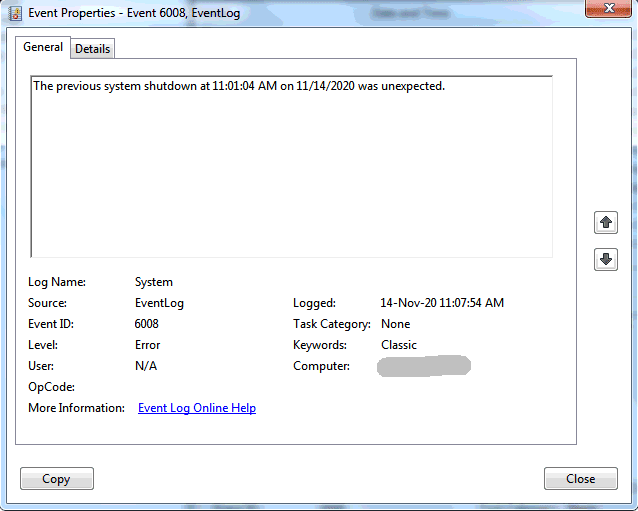

I haven't yet plugged in the HDD into a different port (nor swapped the SATA cable), but today some new system errors were thrown:
1. The PC was working fine for quite some time today.​
2. When Dad got up from the computer and came back around 20 minutes later (the PC was running during this time), he saw that the PC had restarted itself. Event Viewer showed the logs in the following order:​
  • At 10:57:38 AM, a \Device\Ide\Ideport0 error was reported.
  • Time stamps from 10:58 AM to 11:06 AM are missing in the Event Viewer.

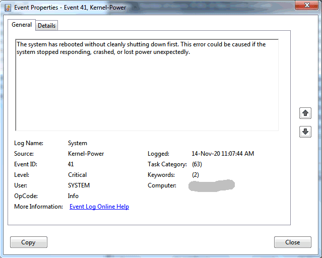

  • At 11:07:47 AM, the following critical error was logged:
Windows 7 Event Properties dialog for Event 41, Kernel-Power, General tab: Level Critical, Logged 14-Nov-20 11:07:44 AM, Event ID 41, Source Kernel-Power, Log Name System.
There were no power cuts, so apparently the OS crashed due to some reason.​
  • At 11:07:54 AM, the following error was shown:
Windows Event Viewer Event Properties dialog for Event 6008, EventLog, showing the message: The previous system shutdown at 11:01:04 AM on 11/14/2020 was unexpected.

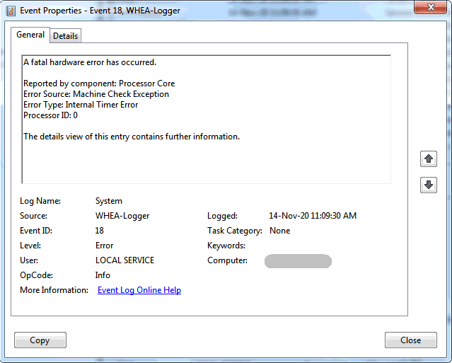

  • At 11:09 AM, reported twice:
Windows 7 Event Properties dialog for Event 18, WHEA-Logger, showing a fatal hardware error reported by Processor Core, Machine Check Exception, Internal Timer Error, Processor ID 0, logged 14-Nov-20 11:09:30 AM.
The details of the above error:​

No one was attending the PC during this period, so we do not exactly know how it was behaving.

Your error report of 11:09 AM reported twice is probably either a power problem of some sort or a CPU problem, either may be thermal. That statement is based on the report stating the error was in the internal CPU timer; with power being much more likely.
First step is make sure the CPU fan is running, without any bearing noise. Also check for a dirty CPU heatsink, clean with 'canned air' and/or with pipe cleaners. (Pipe cleaner = those fuzzy twisty things used to clean a tobacco pipe.) If using canned air, be careful not to get any fans spinning too fast, over-speeding them can quickly damage the bearings.
Then, if you have some 'canned air', blow dust out of the power supply. If canned air is not available, you could use the exhaust of a vacuum cleaner, if available. (kind of clumsy getting that big hose near a CPU cooler.) Careful about fan speed.
Next step would be unplug and re-plug all of the power connections, making sure they are fully seated. If available, try another, known good, power supply (known good = does it work in a different computer?)
Unplug and replug any cards and the memory sticks.
Power errors are usually from the power supply, or occasionally from noisy incoming power. There is a possibility that the CPU voltage regulator that is on the motherboard has a problem, but that is rare on decent quality motherboards these days. (Several years ago, one of the electrolytic capacitor manufacturers had a problem and several board makers ended up with Many short-lived boards in the field. Everyone seems to have learned their lesson by now.)Leave these steps to the experienced, you don't want to practice here!
Next would be make sure the CPU is fully seated in its socket. Unless you are familiar and comfortable with socketing a CPU, I recommend turning that over to someone that has successfully done several; many things to watch out for.
Although rare, the motherboard itself may just be dirty. I had one computer that washing the motherboard and the graphics card cured several strange problems. (the problems were more random than what you are reporting.) It was used for several years in the environment of a central city near a major seaport with all the diesel exhaust, etc.
These following errors you reported are likely second-order effects of the above.

I did a Google search with "internal timer error machine check exception", and found some websites stating that this should be either a hardware fault (faulty cpu, etc.) or buggy driver. Is there any good software that can check and update drivers for free? A Google search brings up many such softwares, and I am sure not all of them are trustworthy.
