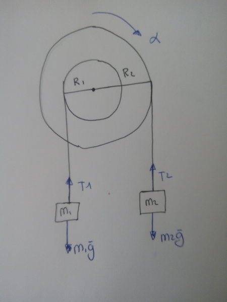

Two blocks are attached by strings of negligible mass to a pulley with two radii R1=0.06 m and R2=0.08 m. The strings are wrapped around their respective radios so that the masses can move either up or down. The pulley has a moment of inertia I=0.0023 kg
m2 , and is supported by a bearing with negligible friction.
1)If block 1 has a mass of 0.6 kg and block 2 has a mass of 0.5 kg, what is the magnitude of the angular acceleration of the system?
2) Idem, but if the system is moving up with an acceleration a_0.
(My problem is part two.)
I have solved the part 1) without problems.
The equations would be:
\begin{equation}
T_1 - m_1g = m_1a_1 \\
m_1g - T_2 = m_2a_2\\
Where:\\
a_1 = \alpha R_1 \\
a_2 = \alpha R_2\\
\end{equation}
For the rotation motion of the pulley:
\begin{equation}
\sum M = I \alpha\\
\sum M = F \times r\\
T_2 R_2 -T_1R_1 = I \alpha\\
\end{equation}
Solving the system equation, I have obtained: \\
\begin{equation}
T_1 = 6.06 N\\
T_2 =4.69N\\
\alpha = 5.117 rad/s²\\
\end{equation}
Where $\alpha$ is the angular acceleration.
My problem comes in the part 2. Ths system inside a lift with an acceleration up.
My attempt solution...
The only thing I think I can do is add to $\vec{g}$ the acceleration $\vec{a_0}$.\\
The equations in the lift would be:
\begin{equation}
T_1 - m_1(\vec{g}+\vec{a_0})= m_1(\vec{a_1}+\vec{a_0}) \\
m_1(\vec{g}+\vec{a_0}) - T_2 = m_2(\vec{a_2}-\vec{a_0})\\
\end{equation}
(In here I am not sure if I have to add a_0 and subtract it, depending if the mass is going down or up. Also if I have to add a_0 to g in the term:$$m_1(\vec{g}+\vec{a_0})$$ and $$m_2(\vec{g}+\vec{a_0})$$.For the rotation motion of the pulley:\\
\begin{equation}
\end{equation}
Should I add the $\vec{a_0}$ in the rotation equations?
PS: I am sorry for my poor LaTeX, I will try to improve it.
You can always go to the accelerated frame. In this frame the effective gravitational field will indeed be ##\vec g -\vec a_0## (note that ##\vec g## and ##\vec a_0## are directed in opposite directions, the first down and the second up) and the problem will be exactly equivalent to the first, but with a different gravitational field.
So, I understand that the equations (4), about dinamic motion, would be:
\begin{equation}
T_1 -m_1 (\vec{g}- \vec{a_0}) =m_1a_1\\
m_2 (\vec{g}- \vec{a_0}) -T_2 =m_2a_2\\
\end{equation}
When the lift is going up. Because someone inside the lift would fell the gravity harder if the lift is going up, for this reason I don't understand why should be $$(\vec{g}+\vec{a_0})$$, as you say...
\begin{equation}
\end{equation}
##\vec{g}## and ##\vec{a_0}## are vectors. In general, the effective gravity will be ##\vec{g_{eff}} = \vec{g} - \vec{a_0}##.
If we put in some numbers. Let ##\vec{g} = -10 m/s^2## and ##\vec{a_0} = + 2m/s^2##, then ##\vec{g_{eff}} = \vec{g} - \vec{a_0} = -12m/s^2##.
But, in this case, in terms of magnitudes: ##g_{eff} = g+a_0 = 12m/s^2##
