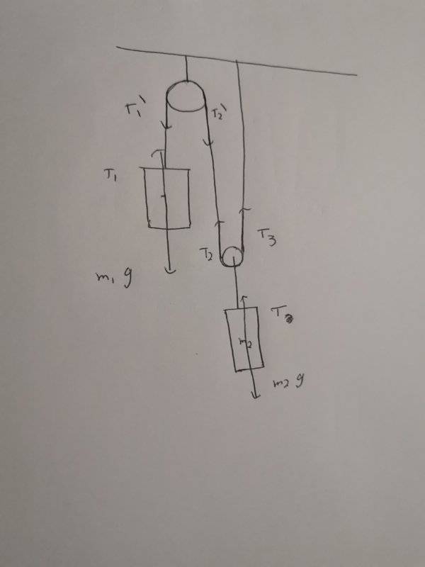

In the diagram to the left, a mass m1 is connected through a fixed pulley to a second movable pulley attached to a mass m2, with a massless wire terminating at the ceiling. The two pulleys are identical, have mass M and radius T,and have moment of inertia 1/2MR^2 for rotation about their axes
1)Sketch free-body diagrams for this arrangement
2)What is m1/m2 when the two blocks are in equilibrium?
3)Write down the four equations describing the motion of the blocks. Hence, find an expression for the acceleration of the blocks in terms of the parameters of the problem and g.

Free body diagram is below, but I have confusion about the tension. The tension on the block and pulley should always be the same by Newton third law. so T1=T1' and T2=T2'.
Part B) The system is in equilibrium so net torque on each pulley is equal to zero. Therefore T1'=T2' and T2'=T3.
Applying Newton second law of motion 2T1'=m2g and T2'=m1g. So m1/m2=1/2.
Part C) Haven't attempted yet but I think a2 should be half of a1, then there's simultaneous equations to solve it
But my confusion is about T1 and T1'.

Your diagram makes it very difficult for us (and probably you) to understand. I suppose we could figure it out from the text, but why not draw one diagram of the whole system so the relationships are clear?
I hope this one is clearer

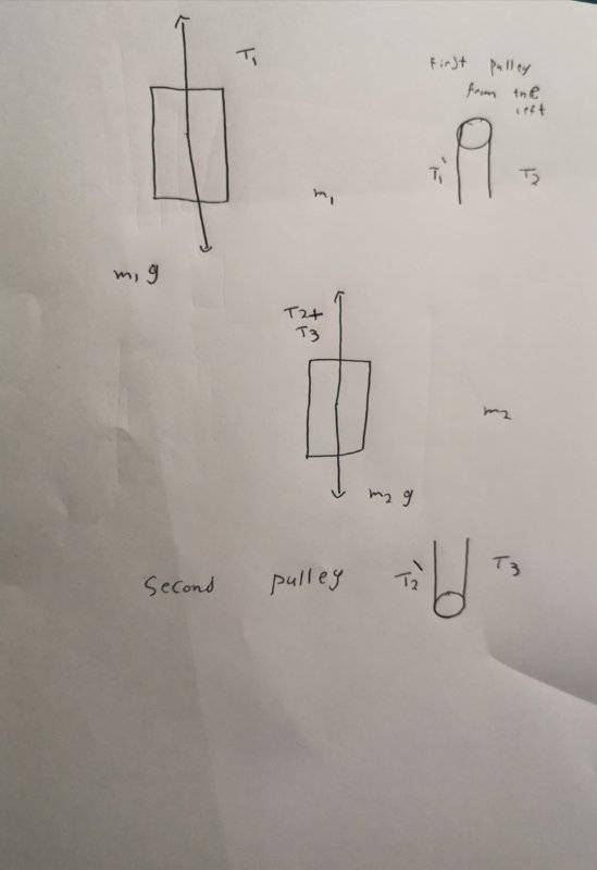

Also, your free body diagrams have several errors that are causing confusion. Don’t forget the pulleys have mass, and also where is the connection between mass 2 and pulley 2?

I am thinking of not including the mass since I will only write the torque equation for the pulley
I see nothing in the problem statement to suggest the mass of the pulleys can be ignored. It could be a reasonable approximation for light pulleys. However here they explicitly tell you they have mass. Besides, if they were light you could ignore the rotational inertia too, and that clearly isn’t the intention.

So I added the weight of the pulley in the diagram. And wrote the force equations. Where small t net torque. and anticlockwise is the positive direction.
for the pulley in the left t=(T1'-T2)R=1/2MR^2α1. Or T1'-T2=1/2Ma1
torque equation for the right pulley R(T2'-T3)=1/2MR^2α2. T2-T3=1/2Ma2
Force equation For block 1 m1g-T1=m1a
For equation for the system of Block 2 + Pulley " Ignoring the internal forces"
m2g+Mg-T2+T3=m2a

So far I got 4 equations of motions.
First for force assume up to be the positive direction
Constrain equation
a1=2a2
T1-m1g=m1a1=2m1a2
T2+T3-(M+m2)g=m2a2
For the torque equation, I assumed that counter clock wise is positive and also assumed that m1 goes down.
T1R-T2R=1/2 M R^2 (a2/R)(2). Since a1=2a2
so T1-T2=a2M
-T2R+T3R=1/2 MR^2 (-a2/R)
T2-T3=Ma2/2
for part b) I putted a=0 So
T1-m1g=0
T2+T3-(M+m2)g=0
T1-T2=0
2T2-2T3=0
So T2=T3 for the last equation
Then T2=T1 for the third equation
So after that T1=mg from the first equation therefor T2=T3=T1=m1g
From the second equation
2m1g=M+m2
so m1=(M+m2)/2
Which kinda make sense, since the mechanical advantage is 2.
Now what's left is part c.
