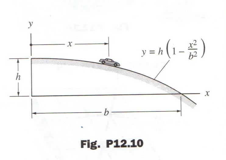

An automobile goes down a hill that has the parabolic cross section shown. (see image attached)
Assuming that the horizontal component of the velocity vector has a constant
magnitude v0, determine (a) the expression for the speed of the automobile in
terms of x; and (b) the magnitude and direction of the acceleration.
y=h(1-x2/b2)
I have attached an image
It gives a solution in (a) v0√1+(2hx/b2)2
and (b) 2hv02/b2
How do I proceed in (a) to come to the given solution?

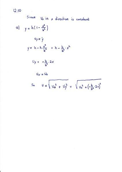

Actually, I was off the mark initially. This is not an energy conservation problem, but a simple application of calculus. You are looking for ##v = \sqrt{v_x^2+v_y^2}##. You know that ##v_x = v_0##, that ##y = h(1-x^2/b^2)## and that ##v_y = dy/dt##. So ...
so for vy = dy/dt i get vy = - (h/b2)2x
and v = sqrt(v02 + (- (h/b2)2x)2)
I don't know how to proceed then
You did not apply the chain rule of differentiation carefully enough. Try again. Remember that x depends on time.

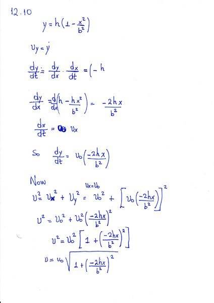

Ok. What I get is different from the given soution at the back of the book.
It is given ##v = v_0 \sqrt {1 + \left( \frac {2hx} {b^2}\right) ^2}##
what I get is ##v = v_0 \sqrt {1 + \left( \frac {-2hx} {b^2}\right) ^2}##
Check also my upload
##\left( -\frac{2hx}{b^2} \right)^2=\left( (-1)\frac{2hx}{b^2} \right)^2=(-1)^2\left( \frac{2hx}{b^2} \right)^2=\left( \frac{2hx}{b^2} \right)^2##

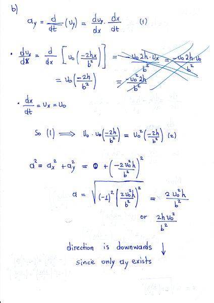

Any hint in finding the magnitude of acceleration?
It should be ##\frac {2hv_0^2} {b^2}##
I have done the ##a_y=\frac {d} {dt}\left( v_y\right) = \frac {d} {dt} \left [v_0\left(\frac {-2hx} {b^2}\right)\right]##. How do i proceed from here?
and ##a_x## should be zero since ##v_x## is constant
Apply Chain Rule, (see @kuruman's Post#6)
It should be as shown at the attached file
