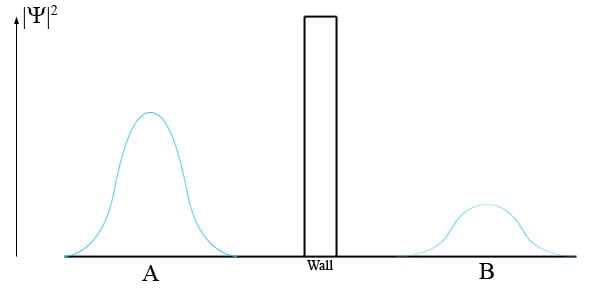

I think I understand what kind of image you have in mind here, where a wavefunction reflects off a wall, but part of it is transmitted. Indeed, the particle could be on either side of the wall. The problem in your statement is that we do not know which side of the wall it is! The only way to know that, would be to make a measurement. If we measure the particle, and we see that it is on the left of the wall, then it is on the left. Period. When you measure the particle, the wavefunction collapses into a spike around the position of the particle. The wavefunction to the right of the wall is now zero, and the particle is definitely on the left.For example: The wavefunction might look like this after it has reflected (and partially gone through) the wall:
When you now measure the particle, there is a large probability that you measure it at A, and a slightly smaller (but non-zero) probability that you measure it at B.

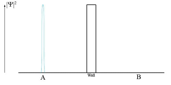

Let's say we measured it at A. The wavefunction after measuring now looks like this:
If we would measure the particle again (within reasonable time) we would expect to measure it again at A, and not at B. The wavefunction is zero at point B now, and therefore so is the probability of measuring it there.

This is a rendering of the wave function being partially reflected and transmitted through a barrier:
An initial wave function, call it W, is split into 2 separate wave functions call them Wa and Wb, one of which is transmitted and the other reflected.
Case A: Wa and Wb can be treated as separate wave functions; it is possible for Wa to collapse and it does NOT cause collapse of Wb.
Case B: When Wa collapses, Wb simultaneously collapses because they are really still part of the same wave function, regardless of their spatial separation.
The wording on wikipedia's page seems to indicate support for Case A. So far I have only seen support for case B in the replies to this thread.
My question: is there any specific evidence or experiment (as opposed to simply quoting theory) supporting one case over the other?

Your case B is the correct one. And yes, there's lots of evidence. As in: Every single experiment ever done on an entangled state. An entangled state, in its simplest form, is two particles describable by one wave function, not a sum of the wave functions of two independent particles.
If an entangled state as you describe it involves two particles, then I don't see that we're dealing with that in the present example. It's just one electron fired at a barrier.
In the case of a single particle that's either reflected or not, if you insist on looking it as two wave functions, then it's two wave functions entangled with respect to location. And measuring the existence of the particle at one location or the other will cause both to 'collapse' into whatever that position is. It will no longer have any probability of existing at the other location.
So the question is: how has that been verified experimentally?
Couldn't tunneling of states (as opposed to particles), which after all is more general, by viewed as evidence of this?
There are a few well-known systems (a Josephson junction would be one example) where the system is initially trapped in an insulated potential well but can tunnel from this (nearly) dissipationless state to a dissipative state where the system is subject to very rapid decoherence (and is therefore "measured"). This system has e.g. been used as a qubit.
As far as I know no one has ever observed a situation where the systems BOTH stays in the non-dissipative state AND stays in the well.
junglebeast said:
Have you considered that the barrier effectively performs a "measurement" on the particle represented by the original wave function, causing it to collapse into 2 separable wave functions (packets) that are not entangled?
No, it does not perform a 'measurement'. There is no need to bring in the Copenhagen interpretation into this problem. Go read up on scattering theory.
Whether you call it a "bimodal wave function" or 2 "unimodal wave functions" is just semantics. You can certainly call it two "wave packets", because the definition of a wave packet is one localized probability density function.
You cannot treat it as such. If you have one localized wave function (wave packet) at one point in time, which then hits a barrier and disperses, the two (or however many) dispersal nodes you get will be interdependent. They do not form a linear superposition of states, as the case would be for separate, independent wave packets.
A wave packet can be split into 2 wave packets by a barrier. That is established by the tunneling page I linked and associated simulation rendering which makes this quite apparent.
Yes, but you don't seem to have done the math. The fact that a wave function has two separate nodes does not make it two separate wave functions representing two independent states of two independent particles.
By simple logic, it follows directly from these 2 facts that "A particle may be split into 2 particles by interaction with a barrier." And hence, these two resulting split wave packets will not be bound to each other.
Show it mathematically then.
junglebeast said:
Thank you conway for trying to stay on track with my original question. However you are not asking the same question I was asking anymore.
You can't separate these issues. Via CI the wave function is a theoretical construct used to describe the behavior of the physical particle. It is the theory which dictates how the wave function behaves and then it is the wave function which tells us what the theory predicts about the physical behavior of the particle.
In short we don't measure wave functions they are not observable. In CI they are not physical. In other interpretations they are given different ontological status but are none-the-less still not observable.
The theory dictates case 2 w.r.t. the wave function and the probabilistic behavior of the particle is as far as experiments have been able to determine consistent with the theory. But the theory cannot and indeed explicitly prohibits (under CI) any ontological descriptions of the physical particle except in terms of what is/was/will be/might be... measured.
Quantum theory is not based on an ontological model like classical theory but rather a distinctly phenomenological model.
Through the experimental verifications of quantum mechanics.
