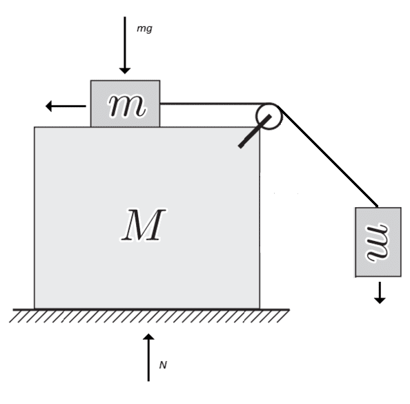

Question about a simple free body diagram
The discussion revolves around the analysis of a free body diagram related to a system involving two blocks and a pulley. Participants explore the forces acting on the blocks, the implications of their movements, and the relationships between their accelerations during the descent of one block. The scope includes conceptual clarification and technical reasoning regarding dynamics and forces in a mechanical system.
  • Some participants question the completeness of the free body diagram, noting missing forces and unclear representations of interactions between the blocks and the pulley.
  • One participant suggests that the lateral acceleration of the vertical block will be equal to that of the larger block, as they are linked by the pulley and string.
  • Another participant argues that the small block should not move horizontally until a tension force acts on it, complicating the analysis.
  • Some participants propose that the horizontal force acting on the blocks is given by ##F=mg/(2M+m)##, but there is confusion about which body exerts this force and on which body it acts.
  • A participant introduces Lagrangian mechanics to analyze the system, providing equations of motion but notes that they have not double-checked their results.
  • There is a discussion about the nature of free body diagrams, with some participants emphasizing that they should depict only one body and all forces acting on it.
  • Several participants express uncertainty about the motion of the blocks, questioning whether the top block moves at all or if it remains stationary while the other components move beneath it.
Participants do not reach a consensus on the correct interpretation of the forces and motions involved in the system. Multiple competing views remain regarding the dynamics of the blocks and the validity of the free body diagram presented.
Limitations include the unclear definitions of forces acting on the blocks, the incomplete depiction of interactions in the free body diagram, and unresolved assumptions about the system's idealization.

There is no external horizontal force on the assembly. So its center of mass cannot accelerate horizontally.
Gravity is vertical. No horizontal component.
The normal support force from below is vertical. No horizontal component.
We assume (but are never explicitly told that I recall) that the bottom surface of the big block is free of all friction. No horizontal component.
Any force between top block and big block is internal. It cannot affect the center of gravity.
Any force between the little-blocks, the cord and the pulley is internal. It cannot affect the center of gravity.
Any force between the side block and the big block is internal. It cannot affect the center of gravity.
We do not discuss reactionless drives on Physics Forums.

I think @PeroK 's analysis with the Lagrange formalism is correct. I'd have a hard time to figure it out with FBDs, but it should be possible.
  • #41
PeroK said:
Newton's laws demand that the Centre of mass of the system does not move horizontally.
In fact, we can use this to get one of the Euler-Lagrange equations directly (without using the Lagrangian). Looking at the horizontal component of the CoM of the system gives us:
$$m(x + X) + (M + m)X = 0$$Hence $$mx + (M + 2m) X = 0$$Differentiating this twice gives us the second E-L equation from my previous post:
PeroK said:
$$m\ddot x + (M + 2m)\ddot X = 0$$
To get the solution, we can relate the KE of the system (as expressed previously) with the lost GPE of the side block:
$$mgx = (\frac 1 2 M + m)\dot X^2 + m\dot x^2 + m\dot x \dot X$$Now, we can use the equation relating ##x## and ##X## to get:
$$\dot X = -\frac{m}{M+2m}\dot x$$And use this to eliminate ##\dot X## from our energy equation, giving:
$$gx = \frac{2M + 3m}{2M + 4m}\dot x^2$$We can then differentiate that to give:
$$\ddot x = \frac{M + 2m}{2M + 3m} g$$And, finally, get:
$$\ddot X = -\frac{m}{2M + 3m}g$$

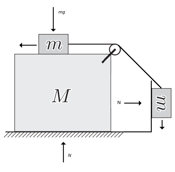

But there are horizontal forces: One is at the mass ##m## lying on the block through the thread connected to the hanging mass ##m## on the right side of the block, and then there's an opposite force of equal magnitude on the block, leading to the horizontal component of the acceleration of the three masses as can be calculated from the analysis in #8.

sysprog said:
the second diagram is a free-body diagram;
No, it's not. A free body diagram contains only one body, and it shows all the forces acting on that one body. To analyze a situation with more than one body, you draw a separate free body diagram for each body.
there is no real apparatus involved -- it's an abstraction;
Doesn't matter what you call it. You still need a description of it

The original question asks:
"… will the lateral acceleration of vertical block ##m## be steadily equal to the lateral acceleration of block ##M##, throughout the descent of vertical block ##m##?"​
Using ##m_{top}## and ##m_{side}## for the two smaller masses, the question can be paraphrased:
Will the horizontal accelerations of ##m_{side}## and ##M## be equal while ##m_{side}## descends?​
##M ## (and its pulley) accelerate left. The angle to the vertical of the string-section supporting ##m_{side}## increases (from zero).
##m_{side}## accelerates left - accelerated by the horizontal component of the tilted string-section’s tension.
The gap between ##m_{side}## and ##M## will change (increase from zero as angle increases). This is only possible if ##m_{side}## and ##M## have unequal horizontal accelerations.
Answer to actual question asked: no!

  • #51
sysprog said:
What force could temporarily prevent it from accelerating leftward? Doesn't the '##M## + pulley' object accelerate leftward only as the ##m## block hanging from it descends? Isn't it that descent that drives the system? How could the hanging block not accelerate leftward immediately? If there is a ##\theta## angle, what would it be? How long would the block hang at this angle with nothing to support it?
Why would that acceleration be delayed? For how long? Tilted at what angle? How would it for some non-zero time interval hold its place laterally, and not as it descended accelerate leftward wrt to the ground? Isn't it true that what accelerates it leftward is the leftward acceleration of the pulley, that is driven by the descent, and that via the unchanging tension of the cord, suffices to impart to the hanging block the same lateral acceleration as the rest of the system, other than the top ##m## block, which accelerates commensurately rightward?isn't it true that the expression ##a=(mg/(2M+m)## is correct for the leftward acceleration within the system, and that the ##m## in that expression is the ##m## of the hanging ##m## block, and that for the system as a whole, the acceleration referenced by that expression is commensurate with the rightward acceleration of the top ##m## block?
That’s al lot of interwoven questions, tangled up with some misconceptions. Impractical to answer - but see if this helps...
Consider what’s happening at the pulley. That’s where the action is at. (Some sort of 60's Lagrangian pun intended.)
The tensions in the 2 parts of cord (left of pulley and below pulley) exert a force on the pulley and hence on ##M##.
The horizontal component of this force is what causes ##M## to accelerate left.
The natural tendency of ##m_{side}## is to move vertically downwards. But since this occurs while the pulley is moving left, the cord attached to ##m_{side}## gets tilted.
As a result, ##m_{side}## is moving vertically downwards while simultaneously being pulled left by the horizontal component of the cord’s tension.
This is a smooth, continuous process with the gap between ##M## and ##m_{side}## smoothly increasing from the moment of release. (A bit like the gap between a ball and your hand smoothly increasing as soon as you release the ball.)
The fact that the lower part of the cord is tilted makes the problem quite tricky. I wouldn't like to spend time trying to sort out the maths. And this isn't required according to the question as stated in Post #1.

I think that it's the leftward component of the tension on the cord.
But there can be no leftward component of tension in the cord unless the large block ##M## has already moved away from the side block ##m##.
If you were hoping to argue that the two will not separate using an argument based on the fact that they do separate, you have some explaining to do.
I think that the leftward component of tension in the cord is what drives all the leftward acceleration in the system.
I had no such hope. I think that they will not separate, but that idea is based is based on the idea that the leftward component of the tension on the cord is based on the balance of tensions between the top ##m## block and the descending ##m## block. I think that the descent of that block is the only driver of accelerations in the system.
We are talking about the acceleration of the right-hand side block and trying to get you to explain why you think it stays in contact with the middle block. The tension of the cord on the right hand block acts in a vertical direction unless the two blocks separate. You are arguing that they do not separate. So your own argument destroys itself.
It is fairly easy to see that if the side block is positioned against the side of the large block that the system will evolve so that the two become separated. It is also fairly easy to see that if the side block is positioned very far away, the system will evolve so that it closes the gap. It seems clear that there is an equilibrium position at some angle in the middle. Based on this, one might expect some sort of oscillation. A damped oscillation, almost certainly. The hard part is deducing a formula for that oscillation as a function of time.
  • #60
It appears to me that you're saying that something like this (presumably with a smaller angle) must occur:
Wouldn't there have to be an external rightward force on the descending ##m## block for that to occur?
