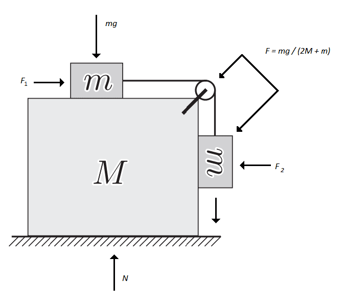

In this diagram, if the system begins by being held static, and then at time ##T## release of all components occurs, at all times ##>T##, until vertical movement stops upon vertical block ##m## making contact with the Normal Force at the base of block ##M##, will the lateral acceleration of vertical block ##m## be steadily equal to the lateral acceleration of block ##M##, throughout the descent of vertical block ##m##?
I struggle to understand the diagram.
You have a force ##F_1## which appears to be the force of tension on the upper mass ##m##.
You have a force ##mg## which appears to be the force of gravity on the upper mass ##m##.
You do not depict any contact force between the upper mass ##m## and the main block ##M##.
You have a force labelled mg/(2M+m) which is applied diagonally to both the pulley and the right hand mass ##m##. That one makes zero sense.
You do not depict any other forces acting on the pulley.
You have a force labelled ##F_2## acting leftward on the right hand mass ##m##. I have no idea what force this is supposed to be.
You do not depict any other forces acting on the right hand mass.
Finally, you depict a normal force ##N## acting upward on the main mass ##M##
You do not depict any other forces acting on the main mass.
You are missing a lot of forces. But your question does not concern itself with that...
Well, what horizontal forces act on the two blocks?
You do not have any of them on your diagram.

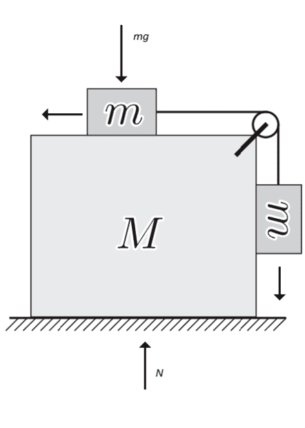

I recognize that the diagram is unconventional and partly incorrect (arrow at upper left is pointing in the wrong direction). What about this diagram?
Wouldn't the large block and the vertically hanging block move horizontally? The horizontal force should be ##mg/(2M+m)##, right?
Things are worse now. You have three free objects on your diagram and a total of four forces depicted.
Which horizontal force are you talking about?
##F=mg/(2M+m)##

It would help if you did a free body diagram of each of the objects shown in your original drawing. Note that your original drawing is not a free body diagram. Moreover, you don't include a description of the apparatus. Physics is a study of the phenomena, not of drawings in textbooks.
Yes, the first drawing is in incorrect; the second diagram is a free-body diagram; there is no real apparatus involved -- it's an abstraction; your remark about Physics seems to me to be overly restrictive.

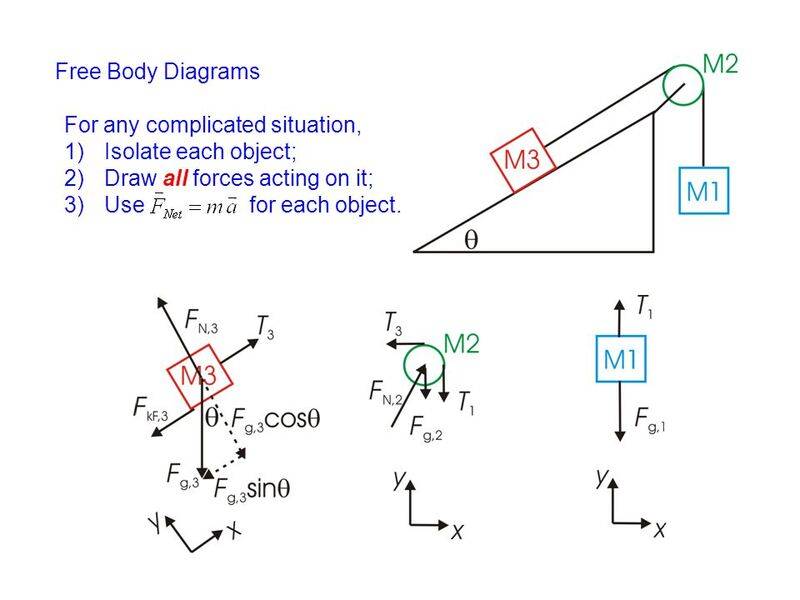

Free-body means that you draw all bodies separately with all the farces on each, like shown here for a similar scenario (slide 1):
https://slideplayer.com/slide/4164519/
But In your case you you want to include the block M too, nut just the pulley.
(Thanks for that to-the-point illustration.) Block ##M## is connected to the pulley, whence the reference to the '##M## + pulley' object.
