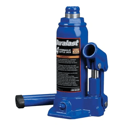

I'm sure you have seen hydraulic jacks like the one in the picture. How can a man with little effort lift a 4 ton load? It is the same principle.

I'm sure you have seen hydraulic jacks like the one in the picture. How can a man with little effort lift a 4 ton load? It is the same principle. View attachment 253409
My hunch is that it would just be like Pascal's Law and that we would treat the atmosphere as the applied force. Something about it seemed counter-intuitive to me because I suppose a constraint would be simply having enough water to actually fill the larger column. Also sometimes I forget to consider that a pressure change applied to the fluid is a change distributed throughout the fluid, so it has to work to raise the large column. T
