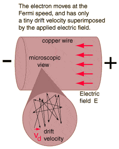

As Mr. Sparkle has pointed out, the electrons do NOT travel anywhere close the speed of light. In fact I don't think they even travel close to the speed of walk. Consider a small pipe filled with marbles. If you push another marble in on one end a marble on the other end falls out immediately. Each marble is traveling very slow compared to the effect from one end to the other.
Yep. For copper, the electrons drift velocity is a few millimeters per second.
Microscopic View of Ohm's Law
