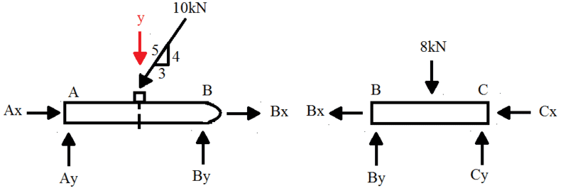

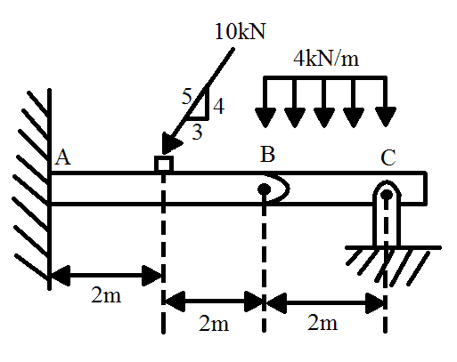

The beam AB shown is connected to beam BC.Find the reaction at each supporting point and moment at A.
This is the FBD given by the lecturer:
Actually,I get the answer but not sure correct or not.These are my answer:
y=0.14kN
Ax=0N
Ay=0.07kN
Bx=0.105kN
By=0.07kN
Cx=-0.105kN
Cy=7.93kN
Someone please tell me whether my answer are correct or not.If not,please give me suggestion.Thanks
I am not sure why you are getting decimal numbers..the vertical load for examople is 16 kN down, so the vert reactions at A and C must add to 16 kN up. And the horiz reactions must add up to 6 kN. The reactive moment at A is missing from the free body diagram. The problem is statically indeterminate..to get the horiz reactions, you have to use axial deflection compatability equations (A will 'hog' most of the horizonatl load.)
This is statically determinate, the extra equation coming from the zero bending moment at B. What is the bending moment at B, taking moments to the right of B?
Both ends are restrained from lateral movement, thus, the problem is statically indeterminate in the x direction.
Apologies. Jay is right. But I wonder if the question is correctly illustrating what was intended?
Yes, I have my doubts also.
