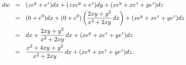

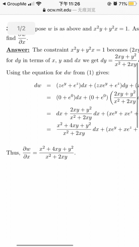

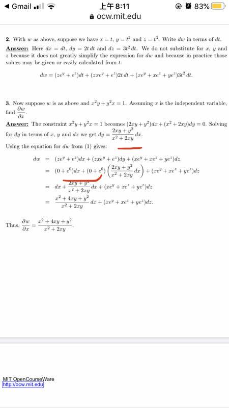

In part 3 of this example, after dy was expressed in terms of dx, can someone explain to me why z in the total differential equation dw was set to zero? It doesn't make sense to me at the moment.

I don't see anything set to zero. I see ##ze^y\,dx = c\,dx = 0##. ##ze^y## is a constant ##c## from the point of view of the differential operator ##dx## since it does not depend on ##x##.

I can't make much sense of that either. Perhaps they forgot to say that they wanted ##\frac{\partial w}{\partial x} \big{|}_{z = 0}##. That's what they seem to have calculated anyway.

The way z is set to zero here doesn’t make sense to me. Also the fact that dy isn’t negative.
That looks plain wrong.

So, (1) says
1. Find the total differential for ##w=zxe^{y}+xe^{z}+ye^{z}##.
$$dw=(ze^{y} + e^{z})dx + (zxe^{y} + e^{z})dy + (xe^{y} + xe^{z} + ye^{z})dz$$
(2) asks us to write dw in terms of dt. That part is unrelated to the confusion.
3. Now suppose ##w## is as above and ##x^{2}y+y^{2}x=1.## Assuming x is the independent variable, find ##\frac{\partial w}{\partial x}##.
They proceed to say the following (after mistakenly writing ##
dy=\frac{2xy+y^{2}}{x^{2}+2xy}dx## instead of ##dy=-\frac{2xy+y^{2}}{x^{2}+2xy}dx##):
@fresh_42 They end up arriving at
$$\frac{\partial w}{\partial x}=\frac{x^{2}+4xy+y^{2}}{x^{2}+2xy}$$
I think the given solution is incorrect. Nowhere is given that ##z=0##.

I would make the assumption that that page is unreliable. It specifically sets ##z = 0## that is clear.

I have had another look on the original pdf, and meanwhile I think that the error comes in with the constraint. Maybe they implicitly meant by ##x^2y+y^2x=1## that ##z=0##. That's the only way this all makes sense to me.
I suspect whoever wrote that page confused ##dz = 0## to get the partial derivative wrt ##x## and ##z = 0##. In any case, I can't see much value in trying to make sense of poor material.
