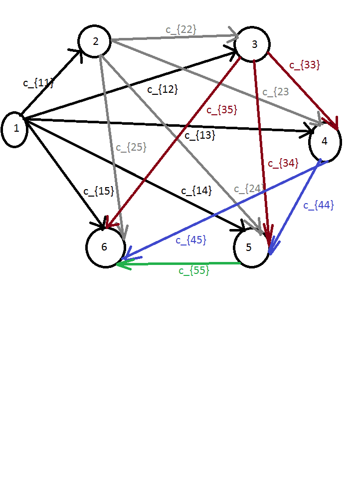

I suggest checking if the following idea works. Given a grouping problem, we construct a directed graph. The vertices are $1,\dots,n+1$. There is an edge from $i$ to $j$ iff $i<j$, and its weight is $c_{ij-1}$. Then the minimum grouping cost is the shortest distance between 1 and $n+1$.

Could you explain me why the weight for the edge from $i$ to $j$ iff $i<j$ is $c_{ij-1}$ ?
Are you wondering why the edge from $i$ to $j$ corresponds to $c_{ij-1}$ as opposed to $c_{ij}$? For one, a segment consisting of one object #$i$ makes sense and has a cost $c_{ii}$. On the other hand, a loop is never a part of the shortest path.

And also, why are the vertices denoted till $n+1$ ?
If you need to employ $c_{in}$ and, according to the reasoning above, the second index is the result of subtracting 1, then the last vertex should be $n+1$.
For each partitioning problem you get a direct graph. You should prove that there is a bijection between partitions and paths from 1 to $n+1$, and it maps cost to length. Then minimal length would correspond to minimal cost.

For example for n=5, is the graph the following?

Yes.
