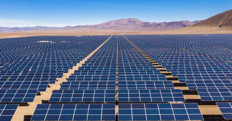

Keep thinking creatively, that's a good thing. I'd definitely suggest that you do some Google searches with different search terms to see what-all has been tried so far. High-efficiency solar conversion is a favorite area of interest of mine (but I've been out of the main loop for several years now). The multi-layer approach is being used so far because of its relative simplicity, compared to trying to split up the incoming light into different wavelength bands and directing that to different solar panels.
Keep in mind that a workable solution has to be able to handle fairly large areas of solar collection in order to be cost-effective. So even it you can do a light-splitting setup on a tabletop, it doesn't mean that it may be practical in an installation the size of multiple football fields...
https://www.irena.org/-/media/Image...ENA_Latam_Caribbean_Solar_Growth_2019_art.jpg
