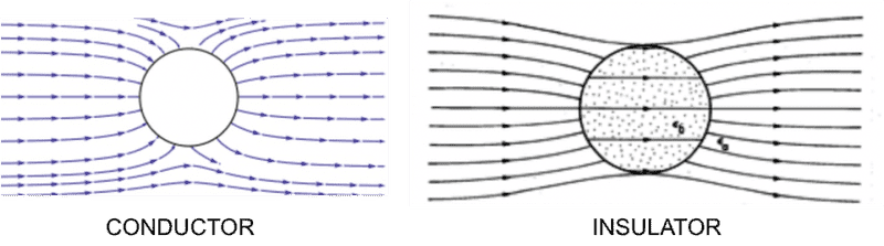

I have appended pictures of a conducting and an insulating sphere placed in a uniform electric field. Study them carefully and imagine the equipotential lines everywhere in the space surrounding the spheres in each case. Also note that (a) there is no field inside the conductor while a field weaker than the external field exists in the insulator; (b) the E-field lines are perpendicular to the surface of the conductor while they are not in the case of the insulator. I already explained to you why electric field lines must be perpendicular to the surface of a conductor. Why they are not in the case of an insulator is a topic that is clarified in an intermediate physics course on Electricity and Magnetism and you don't have to worry about it for your lab write up.

aaaaa i see to understand now. i understand the whole concept of why equipotential lines most be perpendicular to the electric field now, and I spend some hours online reading about them. My book does not seem to be good at explaining this. So the reason why equipotential lines are parallel to the surface is because since there are eletric fields touching the surface, then the equipotential lines will be parallel to those electric fields and parallel to the conductor surface. (by looking at the picture you attached). And the reason why equipotential lines are perpendicular to the surface of the insulator is because since there will be electric field lines inside of it, then the equipotential lines will be parallel to those electric fields, and thus perpendicular to the surface because the insulator has a constant curvature at every point. All is clear to me now! thanks!
You are welcome. A picture is worth 1000 words. :smile:
