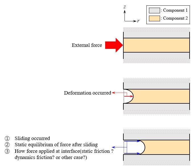

Hello, I have question about friction at inteface between two component
slip occurs at interface when external force bigger than friction force(= normal reaction force * static friction coefficient)
After slip occurred, component motion stopped and got new static equlibrium state
In this state, how force applied at interface? static friction applied? dynamic friction applied? or other case?

ohmyshoulder said:
... got new static equlibrium state
If there is no slip anymore, but the object is still deformed, then you have static friction.
Thank you for applying!
I got theory about this problem named "stick-slip mechanism"
It's so hard problem to understand.
I would have to study a lot
thank you
