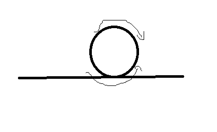

Ok so please bear with me here and what is almost certainly a really stupid question, partly because I don't quite know how to ask it.
When you have a wheel such as one attached to a car, a torque is applied to it from the engine. It's my understanding that the wheel would slide over the road and the car would not move if it were not for static friction which is of course the concept of rolling without slipping.
The problems I am having is when I consider what the magnitude of the force exerted on the road from the wheel would be, or specifically the equal and opposite force exerted back onto the wheel from the road via static friction. The reason for this is because I want to say that it is just the torque exerted on the wheel by the engine divided by the radius of the wheel but that seems to lead to a ridiculous conclusion. If I follow that logic, then the equal and opposite force exerted on the wheel by the road, multiplied by the radius of the wheel to get the counter-torque, is equal to the torque exerted on the wheel by the engine but in the opposite direction. That of course would mean that there is no net torque and the wheels would never move (unless the force were greater than that available from static friction but then it would just slip) which means that the car would never be able to move!
Does the torque on the wheel become the force on the road, such that the only force the wheel feels is the reaction from the road on the tire propelling it forward?
So simply put, what am I missing that is almost certainly staring me in the face (again)? Clearly things roll and cars move so I know I'm going horribly and embarrassingly wrong somewhere.

IF I draw a freebody diagram on the wheel, all I see is a torque on the wheel and a torque from friction, which cancel out
I am missing something and icannot figure it out. which is why I am asking it again, but hopefully with more clarification

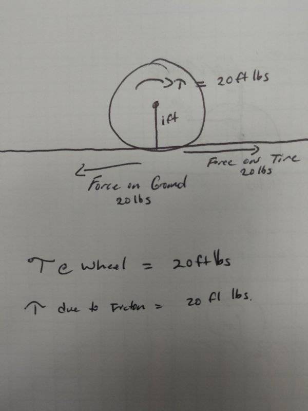

You say the torque of the axle on the tire and the torque of friction on the tire cancel. Can you share the reasoning leading to this [false] conclusion?
It is worth pointing out that these are torques. If you expect the car's linear momentum to change, you need a net force.

When I think or draw out the tire, I see it has a torque from the axle. I see there is a torque from friction. The reminder net torque causes wheel to roll. But then what I read say it is the net external friction force that propels the car forward. Where does that come into play?

If you are distinguishing between tire and wheel then no, the torque applied to the tire by the ground can be different from the torque applied to the wheel by the tire.
There is a relevant equation. It is the rotational analog of Newton's second law.

The force of road on tire is external to the tire+wheel+axle+differential+body+driver+etc = car system. With an unbalanced net external force, the car moves.
The torque of axle on wheel and the torque of ground on tire are both external to wheel+tire system. With an unbalanced net external torque, the wheel+tire system rotates [or at least changes angular momentum].

You do have a problem with numbers. You believe that two numbers are equal which are not. To see that they are not equal is a matter of setting up the equations and solving them.
How could there be a torque from friction without a force from friction?

As for a free body, here is what I have. I am applying a 20 ft-lbs torque to the tire. The tire applies a 20lbs force against the road. The force of friction applies 20lbs back at 1 ft distance...hence aren't torques equal?
Also, how does the static force propel it forward?
This is the best drawing I can muster, I don't know more. Id love someone to fill in the blanks for me. Right now I am just guessing, looking for a real breakdown.
