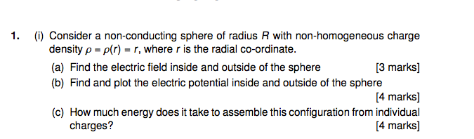

I'm having trouble with the second part b) for this problem.
I used Gauss's Law and for a I got
r<R
[tex]E = \frac{{r}^{2}}{4\varepsilon}[/tex]
and for r>R
[tex]E = \frac{{R}^{4}}{4\varepsilon{r}^{2}}[/tex]
and then
[tex]V = \int{E.dr}[/tex]
from r to infinity right? So
for r>R I got
[tex]V = \frac{{R}^{4}}{4\varepsilon r}[/tex]
but for r<R
I get [tex]V = \left[ \frac{{r}^{3}}{12\varepsilon}\right][/tex] from infinity to r so I would get infinity which doesn't make sense,
can someone help me please?

Yes, to get V at r inside you want the integral [itex]V = \int{E.dr}[/itex] from r to infinity. But you'll need to break this up into an integral from r to R and then from R to infinity. For R to infinity, you can just use your result for outside.

First find the potential at distance 0< r < R inside the sphere. (Hint: think of shells) Then we know for electrostatic case ##E=-\nabla V##.
For outside the sphere, you were right in using gauss's law.
Hint: It's much easier to use the local form of the electrostatic Maxwell equations (as is almost always the case). Here you just can make the ansatz
[tex]V(\vec{x})=V(r) \quad \text{with} \quad r=|\vec{x}|[/tex]
and solve the (now ordinary) differential equation (written in Heaviside-Lorentz units)
[tex]\Delta V=-\rho \; \Rightarrow\; \frac{1}{r} \frac{\mathrm{d}}{\mathrm{d} r} \left [r V(r) \right ] = -\rho(r).[/tex]
This reduces the problem to two simple integrations.
