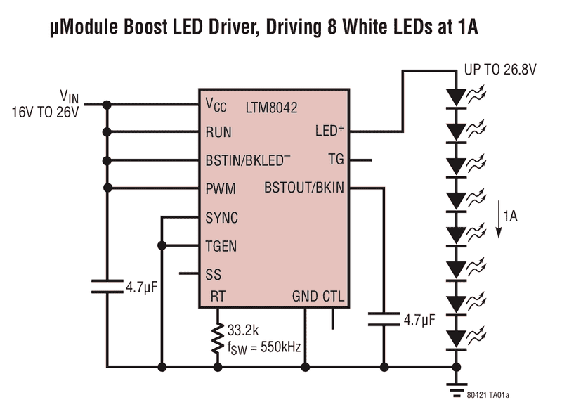

Run this one by him:
LED lighting is just one example where you want a high impedance output for its constant current characteristic.
http://www.linear.com/product/LTM8042
