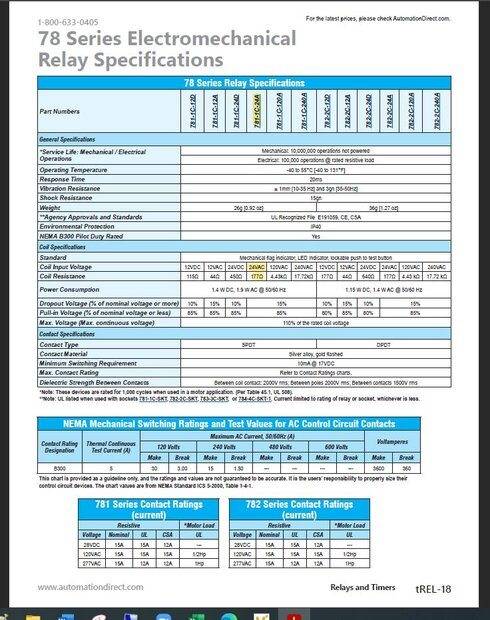

Maybe a not well thought out question:
https://cdn.automationdirect.com/static/specs/78relays.pdf
781-1C-24A Relay is listed as having ##177 \Omega## Coil Resistance. I'm assuming that figure will give the Real Power dissipated by the coil (entire relay circuitry) for some current ##I##, or some voltage ##V_{ac}## across its terminals?

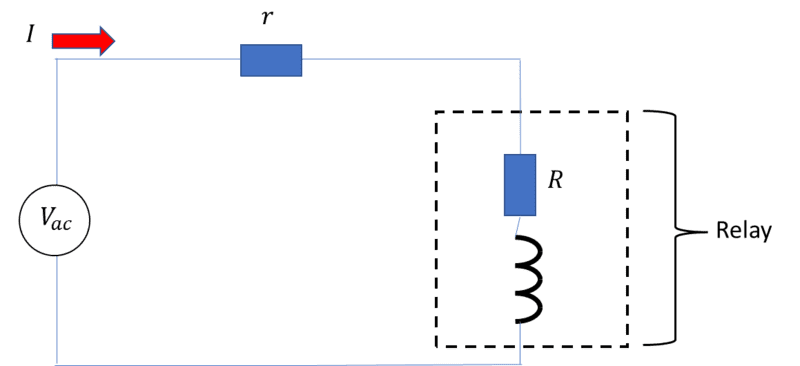

The whole circuit seems to be acting like this:
I'm taking ##R## to be ## 177 \, \rm{\Omega}##, and ##r \approx 0.83 \, \rm{\Omega}##, ##V_{ac} = 24.6 \, \rm{V}## ( I don't know the supply phase angle).
So I'm thinking I don't need the inductance of the coil here to calculate the magnitude of the current in the circuit. The voltage across the relay is ##24.5 \,\rm{V}##, so that leaves ## 0.1 \, \rm{V}## across the ##r## (the resistance of the transmission lines), yielding ## 119 \, \rm{mA}##.
The inductance only effects the phase angle here I suppose.
Actually, I think I'm only getting away with this because the inductance of this coil must be small in comparison to its resistance. The inductance does affect the magnitude of the current in the circuit.
$$ |\mathbf{Z}| = \sqrt{ \left(177+0.83\right)^2 + X_L^2} \quad \Omega $$
But I believe its safe to say that worst case the highest current in the circuit is ##138 \, \rm{mA}##, since any appreciable inductance will drop the current?
Is the inductance of this coil "computationally hidden" in some way in the data sheet? As far as I can see it's not listed anywhere. Maybe by omission the manufacturer is saying to just ignore it in computations?

What was overlloked in the discussion so far is that the 177 Ohm coil resistance that the OP referred to is for a 12V DC relay, in which case the AC reactance does not exist (unless you are driving it with AC).
<page 3 Coil Specifications of datasheet:
https://cdn.automationdirect.com/static/specs/78relays.pdf>
The coil resistance, voltage, and power do not exactly match the theoretical unless you assume the coil resistance tolerance is -12% AND the voltage tolerance is +12%.
Using those worst-case tolerances yields a worst-case power dissipation of 1.16W, close to the datasheet value of 1.15W. (-15%R and +10%V also work)
The image in post #3...
https://www.physicsforums.com/attachments/1664562671186-png.314845/
...would apply to the 12VAC relay with a coil resistance of 44 Ohms and the power drain (1.4W) specified for 50/60Hz. Those numbers supply enough information to work out the inductance for those willing to make the effort. As a note, the AC power dissipated would be due to the 44 Ohm coil resistance.
As others have pointed out, the inductance will be lower, and the current higher, until the relay armature is fully pulled in.
Cheers,
Tom
Hi Tom,
I think you got your lines crossed a bit
I have 781-1C-24A

Just to bring it back full circle and tie up loose ends - I realized that I can estimate the inductance ##L## of the relay after all without all the ODE stuff. I approximately know the transmission line resistance ## r \approx 0.8 \, \rm{\Omega}##. The internal resistance of the coil ##R = 177 \,\rm{\Omega}## is given by the manufacturer. I measure the voltage drop ( indirectly ) across ##Vr = 0.1 \, \rm{V}## by measuring the voltage across the coil terminals ( ##V_c = 24.5 \, \rm{V}## ). That does fix the current at ##I = 125 \, \rm{mA}##.
That leaves a voltage drop across the "ideal" inductor as:
$$ \begin{align} V_L &= V_s - V_r - R I \\ &= 24.6 \, \rm{V} - 0.1 \, \rm{V} -177 \, \Omega \cdot 0.125 \, \rm{A} = 2.4 \, \rm{V} \end{align}$$
If I assume ##f = 60 \, \rm{Hz}## then it follows that:
$$ V_L = X_L I $$
$$ L = \frac{V_L}{I \omega} = \frac{1}{2 \pi f}\frac{V_L}{I } \approx 0.05 \rm{H} $$
So... not a bad guess for the range before, but it turns out an unnecessary one (I know I'm estimating several values - and not including uncertainty... just a ballpark figure).
If there are issues with this, please let me know.
