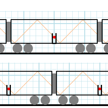

  • #38
Time for me to repost an animation that I first posted in 2015 at https://www.physicsforums.com/threads/how-does-light-slide-sideways.804112/post-5048516

So if I have a vertical laser light clock on a train and a light pulse of the laser goes vertically in its rest frame then in the ground frame where the clock is moving horizontally the light pulse will trace an angled path (not vertical) and the velocity along this angled path should be c also, is this correct?
Also the light stays in the tube but is something making the light beam go horizontally?
  • #45
Did you look at the animation that @DrGreg posted? Doesn't it show exactly this?

  • #46
PeterDonis said:
Did you look at the animation that @DrGreg posted? Doesn't it show exactly this?Yes.In the frame in which the tube is moving horizontally, the tube is, um, moving horizontally. That is what "makes" the light beam move horizontally.
Yes, that animation from Dr Greg was useful.
Regarding the last thing you said, something makes me wonder why light stays in a tube when it moves, what's to stop the light from hitting the sides of the tube when the tube moves?

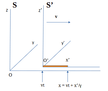

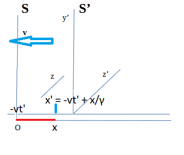

Thanks for the info, I will need to study those equations.
The full Lorentz transform I find a little confusing, I don't fully understand the part where ##\frac {v} {c^2} \Delta x'## the units seem to check out but I'm not sure how that quantity is associated with time.
That term is due to the relativity of simultaneity. That's how it is associated with time.
It is simply how the Lorentz transformations work and mix space and time into spacetime and a necessity for keeping the speed of light invariant.
As others said, this is the (very important to understand) term for "relativity of simultaneity". In Morin's book you find it's derivation in chapter "1.3.1 Loss of simultaneity", paragraph "The 'rear clock ahead' effect".
In the light clock scenario, the left and right side of a wavefront reach a horizontal mirror simultaneously in the light clock's frame and not simultaneously in the lab frame.
If you use the complete Lorentz transformation, then all relevant effects are automatically covered.

PeterDonis said:
Perhaps I should expand on why I put "make" in scare-quotes in my previous post just now.
You seem to be thinking that the light "wants" to move vertically in the frame in which the light clock is moving horizontally, so something has to "make" it go at an angle instead. That's not a good way to look at it.
The light's path in spacetime is invariant; that path is what is dictated by the physics of the problem. Looking at the light clock in different frames just means looking at the same invariant path in spacetime from different viewpoints. From the viewpoint of the frame in which the light clock is at rest, the spatial path of the light beam is vertical; from the viewpoint of the frame in which the light clock is moving horizontally, the spatial path of the light beam is at an angle. But both are viewpoints of the same path of the light beam in spacetime.
That means it is not possible for the light's path in the frame in which the light clock is moving horizontally to be anything other than what it is. Nothing needs to "make" it the way it is. It has to be the way it is, because that's what happens when you take the light's path in spacetime and project it into that particular frame. There is simply no room for it to be any other way. It's as if you looked at the same object from two different angles and then asked what "makes" it look different, as if changing your viewpoint meant something had to happen to the object. Nothing happens to the object when you change your viewpoint. And nothing happens to the light clock when you change frames.
So a light clock will still work in any inertial frame, but the path may look different depending on which inertial frame you're looking at it from.
A light clock will work if it is moving inertially. Or, to say the same thing in different words, it will work if it is at rest in an inertial frame.
The path will be different depending on what frame (inertial or otherwise) you use to describe it.
  • #57
The spatial path may look different. The spacetime path will be the same.
  1. From the light clock scenario, derive time dilation factor ##1/\gamma## and calculate ##\gamma=\frac{1}{\sqrt{1-v^2/c^2}}## with the Pythagorean theorem.
  2. Use this result and the standard twin paradox scenario to argue, that the length contraction factor must be ##1/\gamma##.
  3. Derive the Lorentz transformation from length contraction by using the following diagram.
Solve the shown equation for ##x'##:
$$x'=\gamma(x-vt) \ \ \ \ \ \ \ \ \ \ (1)$$With a symmetry argument, you get the inverse transformation:
$$x=\gamma(x'+vt')\ \ \ \ \ \ \ \ \ \ (2)$$Eliminate ##x'## between the two previous equations and then solve for ##t'## to get the time transformation:
$$t'=\gamma(t-\frac{v}{c^2}x)\ \ \ \ \ \ \ \ \ \ (3)$$With a symmetry argument, you get the inverse transformation:
$$t=\gamma(t'+\frac{v}{c^2}x')\ \ \ \ \ \ \ \ \ \ (4)$$
