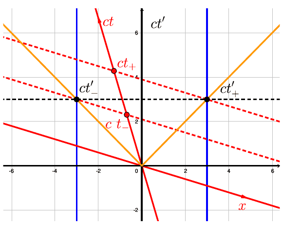

You contradict yourself. Your first paragraph has it right: For the train passenger the light signal reaches the ends of the train at the same time ("simultaneously"), for the observer on the embarkment at different times, and indeed this is called the "relativity of simultaneity".
This is one of the few examples, where it really helps to draw a Minkowski diagram:
The primed reference frame is the rest frame of the train. The passenger in the train sits in the origin, i.e., in the middle of the train and sends a lightsignal at time ##t'=0##. His wordline is the ##t'## axis. From the point of view of the passenger light signal reaches the ends of the train (blue world lines) at times ##t_+'=t_-'##, i.e., simultaneously.
The observer on the embarkment is at rest in the unprimed frame, and clearly the light signal reaches both ends at different times ##t_-<t_+##. That's also intuitively clear, because also from his point of view the light signal propagates with the speed of light in vacuo, ##c##, although the light source is moving with respect to him. Now the one end moves towards the light source and the other away from the light source, i.e., the signal needs less time to reach the former than the latter end of the train.
Mike_bb said:
Is it true that in previous example light reach left end of train with point of view of passenger and with point of view of outside observer simultaneously?
When you say it was "simultaneous" from both points of view, that usually means "at the same time". But the clocks of the two observers indicate different times.

Yes. This is two events, the light reaches the left end and the light reaches the right end. In the passenger’s frame they occur at the same ##t## so they are simultaneous.
Mike_bb said:
with point of view of an outside observer - at different times
Yes. The same two events have different ##t## coordinates in the ground’s frame. So they are not simultaneous in this frame.
Events which are simultaneous in one frame are not simultaneous in other frames.

No, this is not true. As I said above ”simultaneous” is a comparison between two events with respect to one reference frame. If, in a given frame, the two events have the same coordinate, then we say that the events are simultaneous in that frame.
Here you have one event, light reaching the left end, and two frames the passenger’s and the ground’s. The concept of simultaneity doesn’t even fit.
