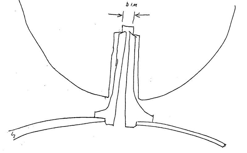

Same jiggler weight, different pressure area. Photo of multi pressure jiggler and pressure cooker vent pipe from Amazon:
Cross section of the vent pipe with weight on it (not to scale):
The top of the vent pipe is cone shaped. The multi pressure jiggler weight has three different diameter seats, marked DIM in the sketch. The largest diameter seat has the lowest pressure, the smallest diameter seat has the highest pressure. Same weight, different area equals different pressure.

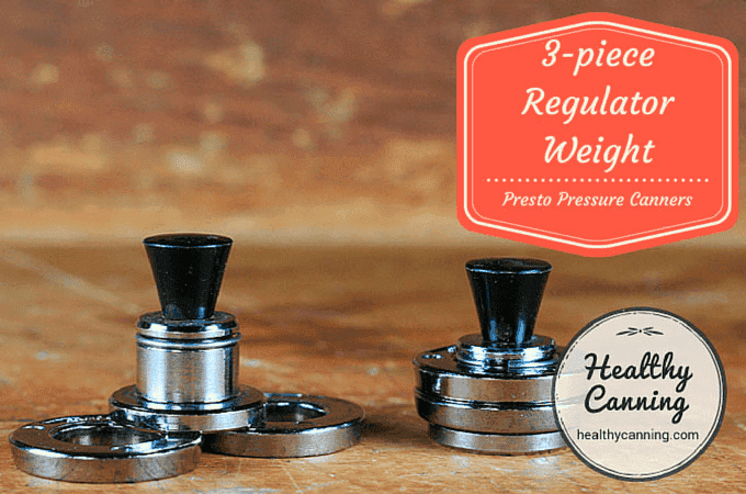

It means jiggler holes have diffrent area for specified pressure? Vent pipe dia is same in all cases...can some one explain P=F/A with refrence to pressure jiggler weight...
I thought they use different weights. Much easier to implement.
However, one weight with three differently machined openings is a much more useful product - only one thing to misplace instead of three and the one thing is always in use so less likely to go missing.

Look at the diagram by @jrmichler in #9 of this thread. The relevant A is not the area of the vent pipe opening, it is the area of the jiggler that is subject to the pressure (because it’s the jiggler that is being pushed around) and that is determined by the geometry of the hole machined in the jiggled.
That could make sense. But the images, where they actually show the jiggler, seem to suggest multiple weights. Something else to lose at the back of the junk drawer in the kitchen.
Whereas the only ones I’ve seen are of the one-weight three-hole design. I expect both styles are in use, wouldn’t be surprised to find it matters which continent we’re on, and might even be a side effect of some decades old patent.

Do you have an image? Bearing in mind that the weight needs to be long, for stability. I couldn't figure a way to drill multiple holes but there again, a number of holes could actually cross each other inside the weight .

I don't, but #9 in this thread has a photo of a three-hole weight They're quite stable because they only lift a few millimeters each burp, not enough to lift off the the vent tube.

Not right - look at the diagram again, and the accompanying photo ofthe vent tube. The bottom of the machined cavity in the jiggler sits on the cone of the vent tube and seals no matter the shape and dimensions of the cavity above. So the cavity is at the same pressure as the interior of the cooker, and the upwards force on the jiggler depends on the area of the upper face of the cavity.

Sketch of jiggler weight in Post #9 was sloppy, so redrawn to be a little better. The sketch shows only one of the three different pressure holes in the weight. Each of the three holes extend almost to the center of the weight, so the larger diameter portion of each hole guides the jiggler on the spout. Each of the three holes has a different minor diameter (DIM in the sketch), which sets the pressure for that hole. Smaller minor diameter equals higher pressure.
Normal cooking does not put food particles up against the hole in the spout. However, cooking the mash to make moonshine does make a foam that can block the hole. In that case, a foam trap is needed both to keep the still from exploding and for finished product quality.
