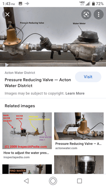

Averagesupernova said:
A quick Google turned up this image. Common setup in the USA.
https://images.app.goo.gl/UVGHCNQ9ot8A5Xpn6

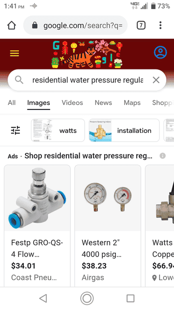

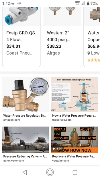

Hey, how did you do that? Clicking on the link takes me to the image plus shows links to the original website where Google Images found it. Neat!
Do you know if pressure reducing valves in the USA are required to control static pressure, or dynamic pressure or both?
I'll post some screenshots that should explain it.
Four screenshots. Android phone. You can see what I typed in. Hit the image you want, click the upper right circle with three dots, option comes up to share. Copied to clipboard, pasted into pf page. You click on the link.
Thanks @Averagesupernova. But none of the images say if the valves are controlling static pressure, dynamic pressure or both.
What the image is calling a pressure reducing valve caps the pressure at an amount that is determined by how far in the bolt with the locking nut is turned. If the valve works correctly the pressure will NEVER exceed the set point. Of course if there is a lot of demand, the valve will fall short and not allow enough flow to maintain pressure. But, many other things dictate this as well such as pipe size, length, etc. It is commonly known as a pressure regulator.
