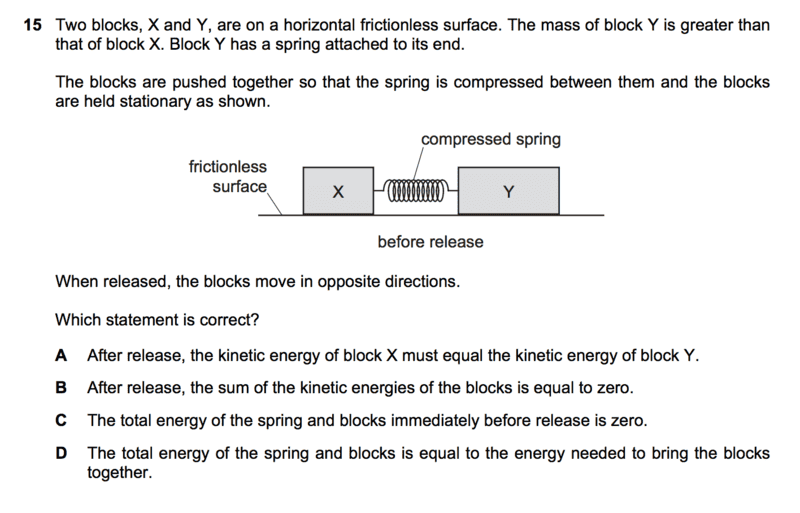

image below
energy equations
My attempt:
my answer was b
correct answer is d
Can you explain why you picked b ?
Do you know the expression for kinetic energy?
because before the release they are stationary
and it is elastic collision, maybe...
so the kinetic energies would add upto 0
so that the total KE is conserved...

"Conserved" means "it is the same" throughout whatever is going on. Before release the sum of kinetic energies is zero because neither block is moving. If, as you claim, this sum is conserved, then neither block should be moving after release. Do you think that is the case?

Why would kinetic energy be conserved? This would mean the blocks just remain stationary as kinetic energy is non-negative.
1/2 mv2
oh ok so, the velocities direction would not be considered.... thats the only thing i understand uptill now
