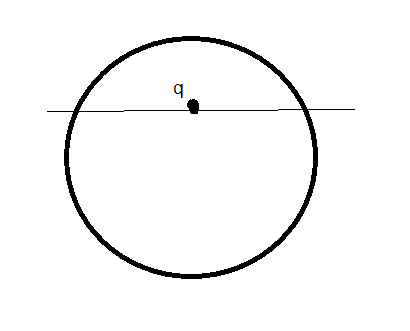

  • #83
Here is another question for the OP or others, which is, I think, crucial in learning about conductors:
Assume a closed surface hollow metal conductor. In equilibrium E = 0 inside the metal. What is the field inside the empty space in the hollow area and why?
[Please prove or justify fully your answer for it to be accepted. Let us give priority to the OP first.]

In a closed surface (say spherical) hollow conductor at equilibrium (meaning uniform distribution), there is no field inside the empty space. This is because the E field from the surface charges cancels everywhere inside- this is true even if you're not in the center. I don't really know the specifics, but I have attached a (pretty bad) picture of how I currently think it goes. The contributions from the top of the line will exactly cancel with the contributions on the bottom (less charges, but more intense on top. more charges, but less intense on the bottom). I'm probably incorrect.
  • #85
You have a good intuition and I think it is correct here (from line to top less charges but stronger field, while from line to bottom more charges but weaker field .../ and you do in fact get zero if you actualy do the integral for any point inside - in the uniform symmetrical case).
And a similar intuition can be built for non-uniform distribution (of charges) and arbitrary [closed] shape hollow conductor, at equilibrium
. In fact this holds even in the presence of an arbitrary external field E (and in fact that's where it gets more interesting). It also constitutes the basis principle of Electromagnetic Shielding (RF shielding is a special case [RF = Radio Frequency]) [cf. Wiki..]. Usually metal is preferred. Such cases of conductors are also known particullarly in the Electrostatic case as "Faraday cage".
The intuition behind it (also along the lines of Sho Kano) is as follows: In the equilibrium (i.e. with [and/or constrained by] some time response parameters, e.g. appropriate frequences vs restoration times [in the case of time varying fields]) the charges inside the conductor will necessarilly arrange themselves in such a way so that the total field is zero on the conductor and inside its hollow.
But why does this hold? What is the mathematical proof (of that theorem)? Anyone is welcome now.
Note: for inside the conductor, the proof was given earlier by Dale (J = σE , thus for J = 0 we get E = 0). Therefore only the proof for the hollow area remains.
