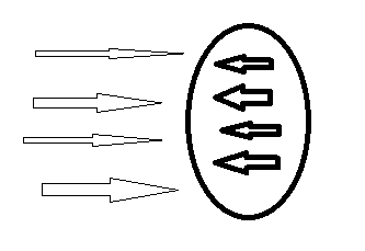

If your conductor is an infinitely long cylindrical wire, the e-field from the electrons cancels out in every direction except radially outwards from the surface

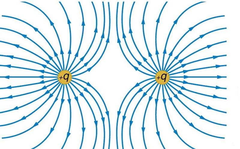

They could cancel out like this? i.e. field lines bend upwards- won't the bottom parts contribute to a net downwards field too?
Alright I understand now; There is a net zero electric field inside a conductor in static equilibrium. If you bring in an electron, it will throw off all the other electrons, and they will rearrange themselves. On a related question, shouldn't the electric field right on the surface of a conductor be zero?

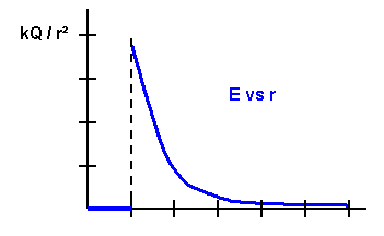

Shouldn't there be a discontinuity at x=r?

Most are, yes. Some are free and move about the conductor. The exact number depends on the material the conductor is made out of. While these free electrons are able to move around, their net motion cancels out overall, so you don't see current flow or charged areas in a neutral conductor.
That only works for two charges. There are MANY individual charges. So many that there isn't anywhere for the field lines to "bunch up" like you see in that picture.
Yes. Looking at this picture though, there seems to be also perpendicular field lines extending into the conductor (from the surface charges)- do these cancel out each other too?

How do we calculate the field at a point on the surface? So would Gauss's law still hold, and we would use the radius of the sphere?
It is discontinuous on the surface.
Yes, over any reasonable distance scale, but the OP is asking - maybe unnecessarily - about the E field in a small region at the "surface."
Okay I understand now, but one thing is still incomplete- the field lines would also point inwards as well as outwards. These inward lines add up to a field inside right?
Imagine you keep adding charges to your picture above. The field lines coming from each electron would be shoved closer and closer together until they just radiate straight outwards, away from the center of the wire. The field inside the wire is zero, meaning that a charge of either type placed in the middle of the wire feels no net force in any direction. This is just like a slice through a hollow, charged sphere.
It is still a bit hard to imagine. Yes the field lines would radiate straight outwards, but it seems like the same would happen inwards even if I bunch the charges up (i.e. field lines radiate straight inwards). But since we know the electric to be zero inside a conductor, what happens to these inward lines?

It is still a bit hard to imagine. Yes the field lines would radiate straight outwards, but it seems like the same would happen inwards (i.e. field lines radiate straight inwards). But since we know the electric to be zero inside a conductor, what happens to these inward lines?
There aren't any. They would all radiate outwards. Remember that field lines are visualization tools that help us visualize the magnitude and direction of the force exerted on a charged particle if placed in that field. They are not a fundamental explanation in and of themselves. If you place a charged particle inside your conductor and then calculate the net force from every single electron you would find that the net force is zero no matter where you place the charge inside the conductor.

I can't visualize why there wouldn't be an electric field inwards. Maybe I have to just downright accept it?
Let me ask you this. In the picture above, what is in between any two field lines? Do charged particles have to be placed on a field line in order to feel a force?
The picture is just a simplification, there are field lines everywhere in space. But if we bunch up a whole lot of them in a line, there will be a net upwards field- And also a net downwards field. The situation doesn't seem to change if we bunch them up along a circle. So in the situation of a circle, we are left with field lines pointing towards the center of the circle.
Well, you can see for yourself from your picture that the lines do indeed bunch up and curve away from the lines of other like charges. We can add as many lines to each charge as we like and this will still be true. If we start adding more charges into our picture, putting them in the shape of a circle, you'll find that the field lines are bent even more strongly. Add enough charges, so many that we can stop thinking about them as discrete objects and more like a continuous circle of charge, and you'll find that the field lines no longer go inward at all. And how could they? If we have so many charges that we can treat them as continuous, any field line inside the conductor would start and end on the same type of charge, which isn't possible.
